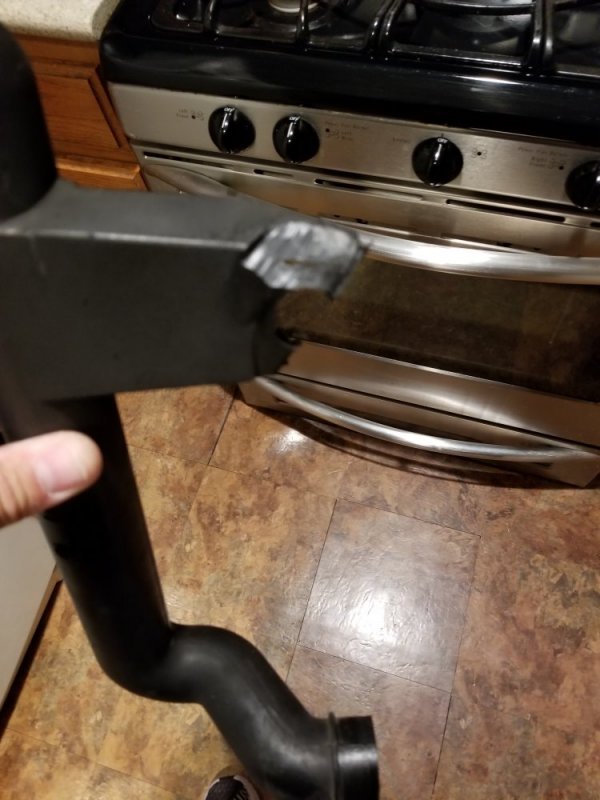

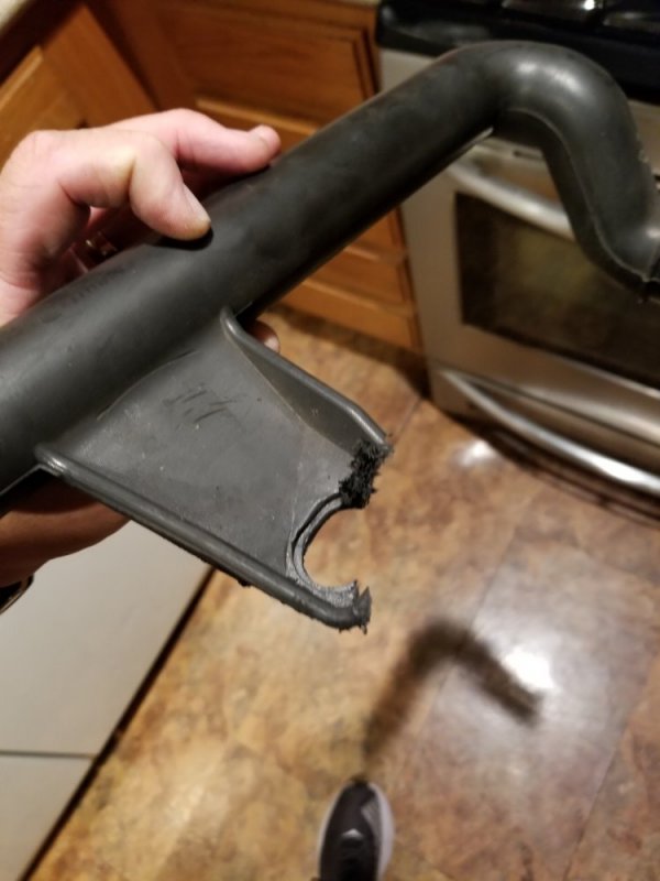

The turbo silencer broke on the suburban. Not a big deal just need to plug the hole. What have you done to plug it?

J-B Weld Plastic bondo stuff will hold it together.
At least it has held on everything plastic that I have used it on. Inner door panels, obsolete tail light lenses and a myriad of other items.

I cut the end of the silencer and used black ultra to seal it and tightened the clamp. Hopefully no issues. It has been 24 hrs of cure time. Time to go give it a whirl.
