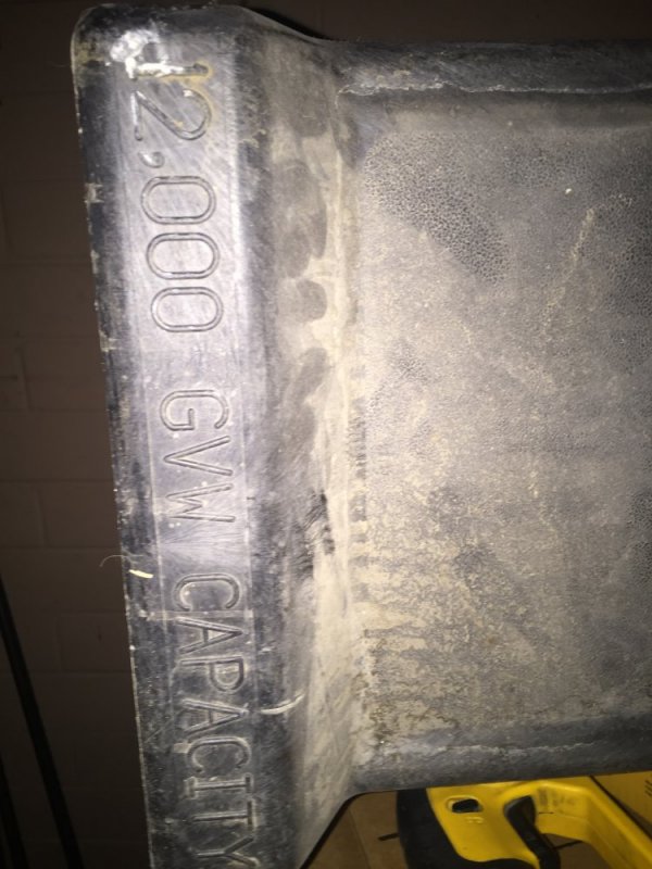

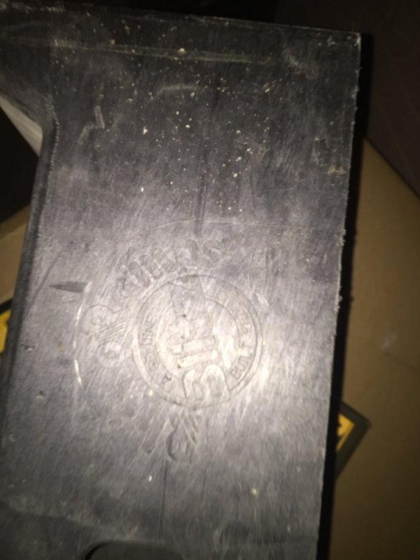

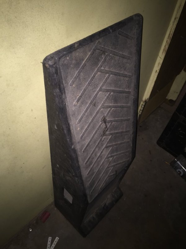

Find some: Blitz Rhino Ramps.
12,000 lbs capable. Very stable, large stops, rubber block on bottom to help traction. I bought mine like 10 years ago or more. Best ever ramp set. Everything from little bitty honda to my hummer (just had to try one time- I can fit 5 gallon bucket under hummer without ramps).
C719FD1F-D8ED-4C8F-94D2-08547FBE84E9.jpeg 23743D70-83EA-4325-A795-DE3BB4DF0171.jpeg 193FEB33-C070-40DC-A6EF-1E6B187274DC.jpeg

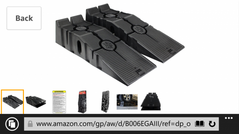

I have a similar plastic set can't remember where I got them. Probably Walmart or Northern Tool. Mine are more like Will's they don't nest. I like the idea of Harbor Freight's that come apart for tire stands (still going to need to jack it up). The ramps and jack stands do get in the way sometimes.
My experience your mileage may vary with floor type and vehicles. And they may have changed. Watch out for this.....
Mine had a rubber cleat on the bottom at the front of the ramp I had to take it out. When I would try to pull a Mazda 5 Minivan onto the ramps they would scoot forward instead of the car climbing the ramps. The rubber cleat was too tall and too far from leading lip plus I have an epoxy coating on my garage floor. It did something weird like a seesaw on the cleat and then skidded the cleat. W/O the rubber cleat it works fine. But I am always a little nervous. Mine even though they are not expensive ones seem ok sturdy, not too heavy, and stand up to store semi-compact. Note the Amazon ones look like the cleat is closer to the lip. Using the ramps with my truck the rubber cleat was never a problem.
Just a little friendly FYI ramps 101 I had to learn the hard way with the scooting forward thing. Also, once I pulled the ramps rearward instead of car upwards and shot them under the car with front-wheel drive trying to ease up on them with light brakes trying to ease it. :bag: I was surprised how quickly they went under the car. I think proper technique is to hit them with a little momentum and either open the door or look out window to watch ramps pulling onto them (probably a good idea with any portable ramps). I pull the vehicle to where I want to use them put the ramps against the wheels then back up and drive up on them slowly in one steady motion not too fast to hit brakes and bump/skid ramps forward.
