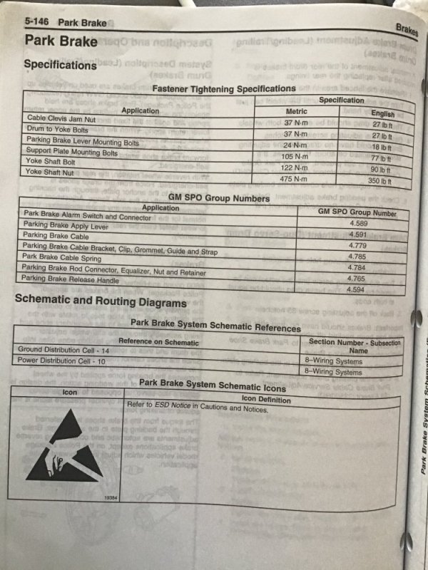

M Mike T New Member Messages 2 Reaction score 5 Oct 19, 2019 #1 Hi all, new member looking for a torque spec for the bolt that holds the yolk on the output shaft on a 4l80e. The truck is a '97 Chevy 3500hd, with the e-brake setup on the tail housing. Thanks

Jaryd Extremely Deplorable Messages 1,959 Reaction score 3,319 Location Hodges, SC Oct 20, 2019 #3 This is from a 98 manual but should be the same I would think.
M Mike T New Member Messages 2 Reaction score 5 Oct 20, 2019 #4 Thank you. Much appreciated. Feel much more confident reassembling it.
