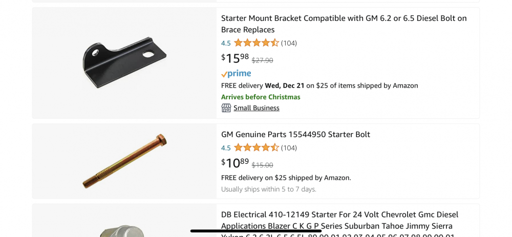

There is a starter bracket that mounts to the block and the end of the starter pointing to the front of the truck. Link to bracket here
Without this bracket securing the end of the starter, the casting where the starter bolts to the block can crack. If this happens an otherwise good engine is turned into scrap.
Once again, make sure both bolts towards the flywheel side of the starter are secured, and the starter bracket is secured to the block and starter.

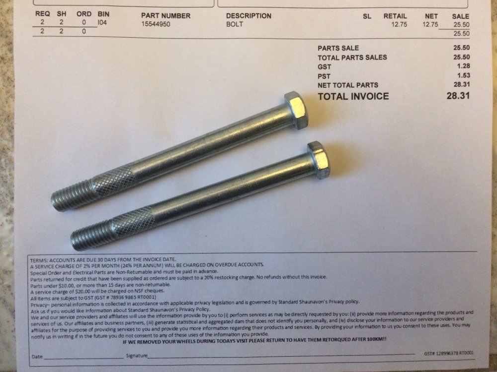

Ok, local dealership wants over 12 bucks EACH for the two starter bolts, but they actually have a few in stock, which was surprising. Have to source washers separately, unless I can reuse the old washers?
They also want $30 for the bracket, not too keen on those prices but I might have to go for that to get her back on the road quick. If I had dimensions for the bracket I could whip one up in no time, all kinds of clean scrap steel at work.
Next question is, should I pull the starter off and check the threads in the block, or just swap the bolts, torque her down and cross my fingers?

Alrighty then, Iā€™ll grab the bolts and get them to order the bracket tomorrow. Any thoughts on the washers?

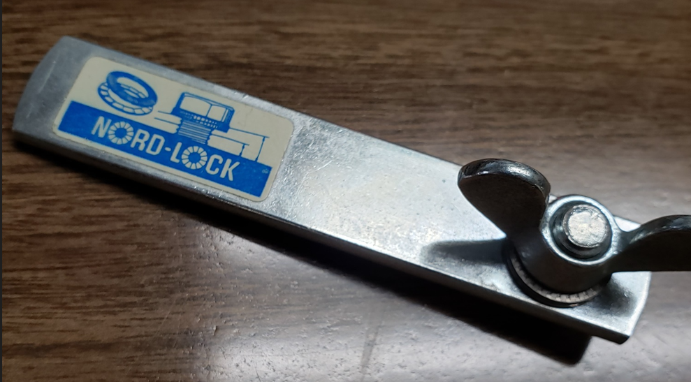

I am in love with nordlocks. Finding them is hard sometimes. Imo I would use the old washers and try ordering some nordlocks to swap later if they donā€™t show up in time.
Here is the sample piece our rep. gave me about 20 years ago. I show it to people and the first thing they do is tighten the wing nut by hand. The next step is me grabbing a wrench to loosen.
I had them on a discharge lip on one of our screens back in 2005, rather than using Huck fasteners. To my knowledge, it's still running without issue.

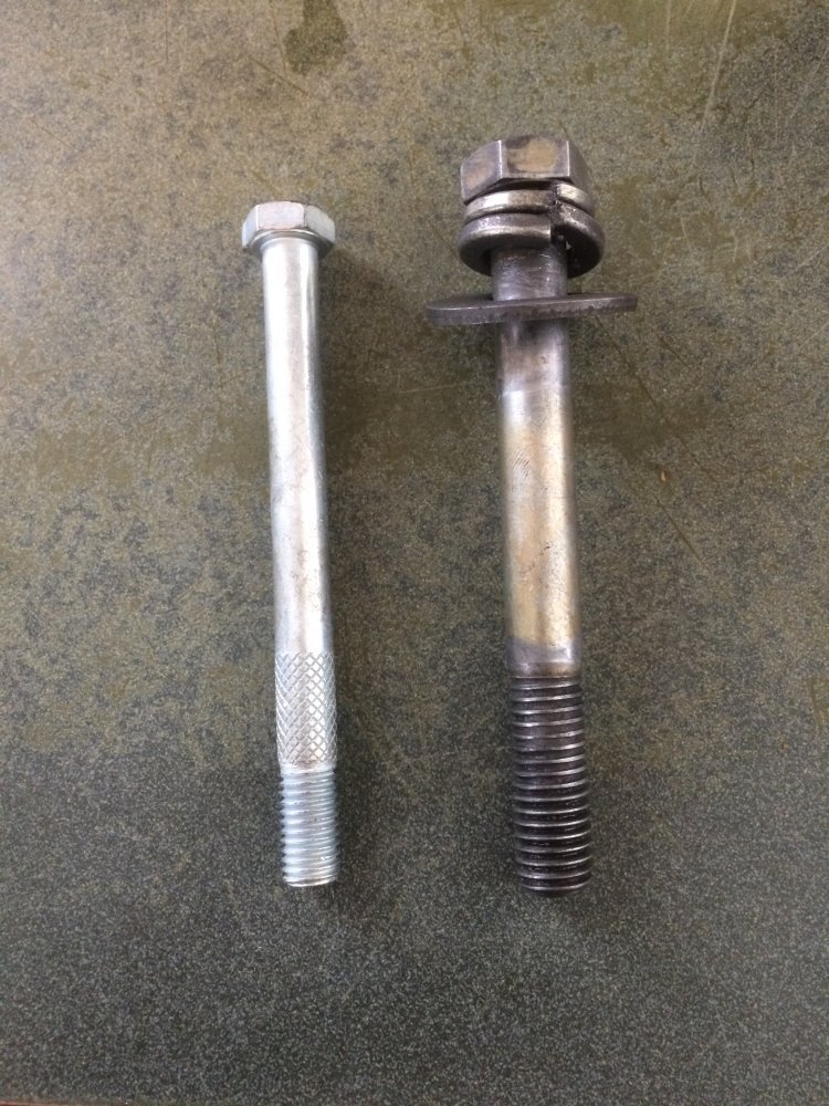

Well well well, bad just got worse.
Pulled the starter and got a bad feeling when I saw the bolts. See pic below. Sure enough, somebody has already been in here and farmered the whole thing up for me.
One of the mounting holes has been Helicoiled, can see the tang in the hole still. Threads in the other one still look good, canā€™t tell if itā€™s been Helicoiled or not, but either way theyā€™re both way bigger than the bolts I got from GM.
So, what the heck am I going to do with this situation? Did GM give me the wrong bolts?

I don't know if it would be worth drilling & tapping for slightly larger bolt and how that would play with the starer fitment
Also just had the idea of getting quality grade 8 threaded rod, cutting to length and JB weld the threaded rod into the block, have the starter held in with just bolts on the threaded rod.
Not ideal any way around, hopefully someone who's been where you are before will have sound advice
