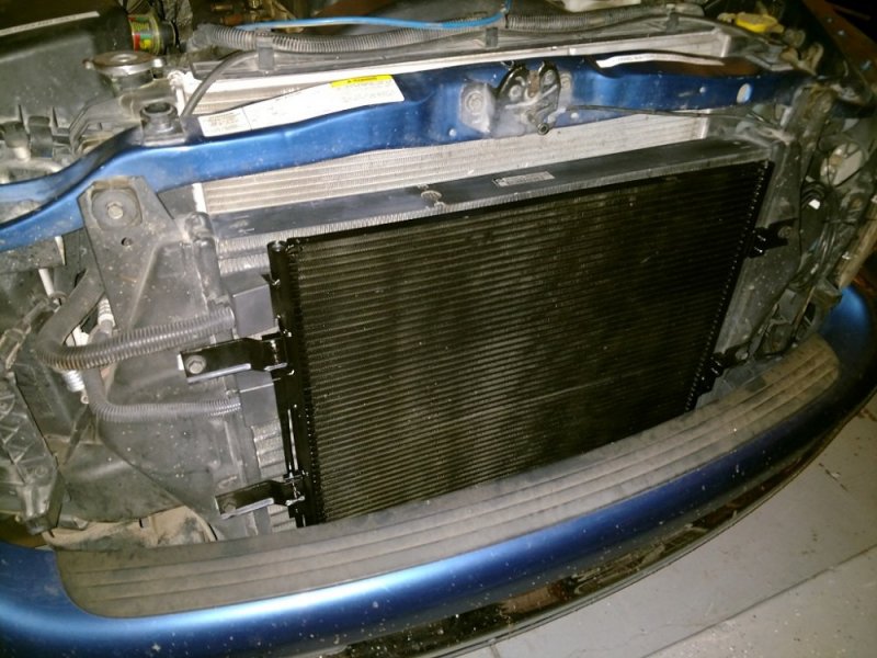

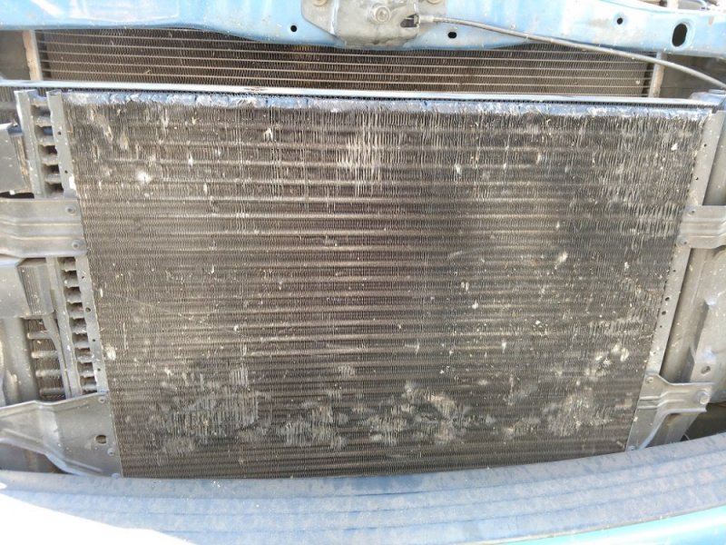

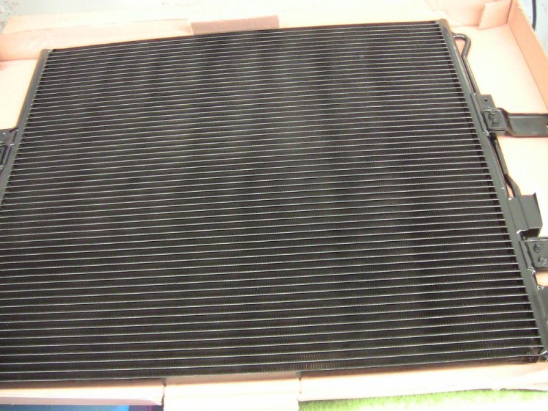

New condenser is in the mail to be coated... I'll take ANY improvement!

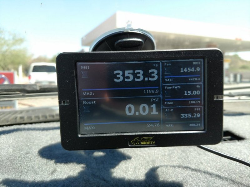

So looking at my favorite trouble spots, automotive AC, I choose to start out with one I can monitor the head pressure and fan speed on. No, not the one giving me trouble - they ALL do. Trouble is the system literally blowing up like you see in the youtube tests as Patch blows out the high side sealing washer on the compressor hose and the Dodge pops the relief valve at 450+ Psig. The Dodge ECM doesn't kick out the AC clutch due to a bug thus it will pop the relief 2x or more per year and dump 1/2 the system charge aka 1 LB. I don't expect it to cure the bug as the second part is not enough fan.

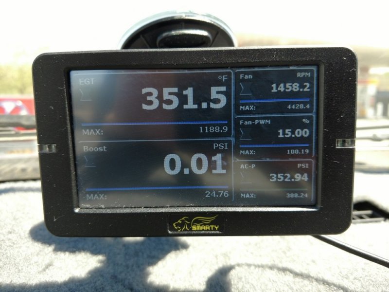

What I would like to see is once I get the fan spinning and let it idle is lower head pressures. On fan speed 3 I will see 350-400+ Psig idling. Speed 4 is asking for it to pass 400 Psig even with ~1400 RPM on the fan at engine idle.
I have a crew cab, but, the Mega Cab's have the same size AC system and it's way undersized for it. IMO coating both the evaporator and condenser may help the undersized system out to cool down that "School Bus" Megacab.

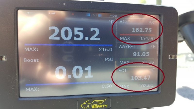

Here is the data readout I will use. It's showing 454Psig max peak on a cold start. (The current reading Psig is the AC shut off as it was running away fast.) I have since added fan commanded % and Fan RPM. This is condenser overheating due to no fan RPM. I don't expect this to be cured.

Results are delayed as I am recovering from frostbite on my nipples due to improved AC performance. :nurse:

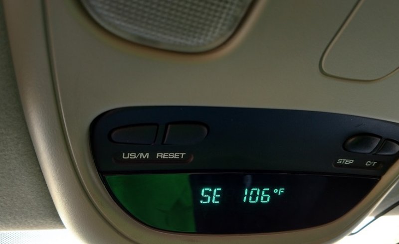

Before (past the critical 105 outside temp) at 106 degrees F:
AC High side pressure runs away to over 400 psig with blower on high at idle. Compressor max pressure short term peak spec is 430 psig. Long term best life under 300 psig. System vents over 450 psig.
Blower speed 3 will creep up to 400 psig from 350 psig at idle.

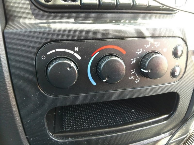

Speed 3:

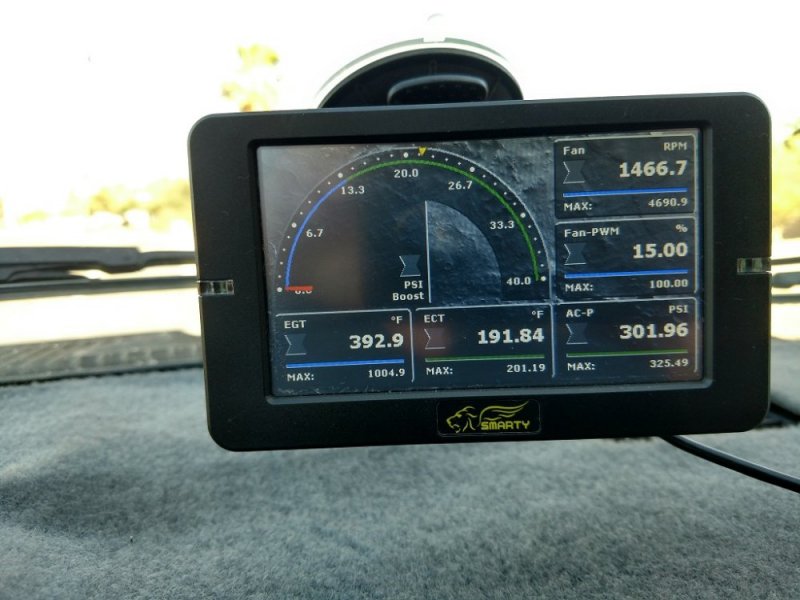

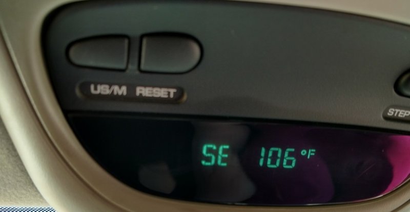

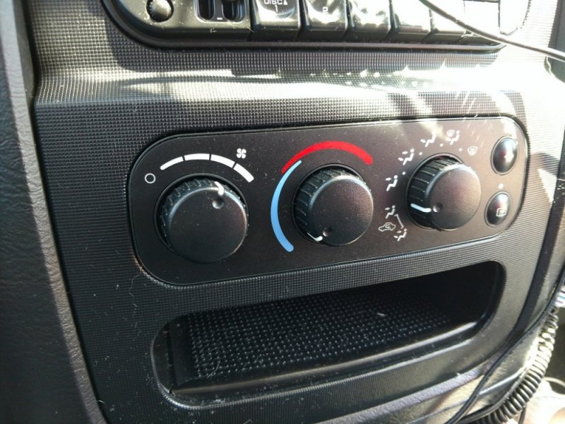

After:
AC High side 302 psig blower on high at idle.
Going down the road 45- 75+ MPH high side is around 200 psig. Before it was kicking the fan on over 230 - 250 psig . YMMV as this is biased on Envirosafe Industrial refrigerant. Efficency, ability to move more heat than R134a are factors I do not explore. Case in point with humidity at 7-15% at 106+ degrees out vehicles with the Industrial refrigerant are dripping water out the evaporator drain - R134a won't do that in these conditions.

111 Degrees yesterday. The Dodge AC is the last vehicle standing. 356 psig on the high side idling with the fan on high.
