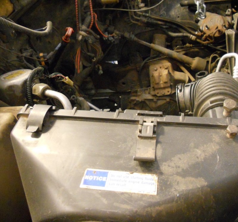

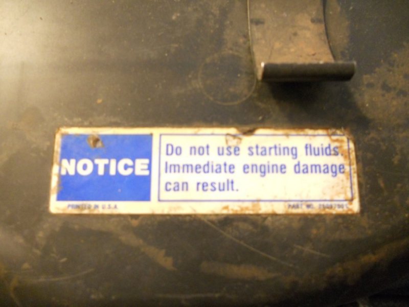

Some diesel engines use ether to start. The 6.2 and 6.5 IDI engine is not one of them. GM put a nice warning sticker letting you know you may be replacing your 6.2/6.5 diesel engine if you use a starting aid. You have a 10+ HP starter, two batteries, 8 glow plugs, a glow plug controller, and optional block heater all dedicated to starting the cold blooded diesel.
What could possibly go wrong?
TheTruckStop.us members and supporting vendors are dedicated to help you answer just this question. If it isn't starting normally something is wrong that needs to be fixed. No need to put off fixing it and risk the engine damage while putting repairs off.
Unless it's a life and death emergency where 911 won't work and there are no strangers around to help you: avoid ether use. You make the ultimate decision as you are there and we can only second guess you.
If you wish to try it out disable the glow plugs (and/or grid heater on other diesels) first. These can light the ether off in the intake with the flame coming back to the can you are spraying from or shrapnel from the intake blowing up makes the emergency worse.
Unlike a gas engine that spark ignites the ether to sanely get going a diesel uses ether for heat. The ether explodes on the compression stroke attempting to drive the engine backwards, but, generates needed heat to light off the injected diesel fuel mist. At 21:1 compression ether exploding on the compression stroke is likely to cause problems with the light duty IDI we have.

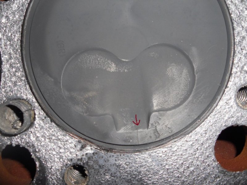

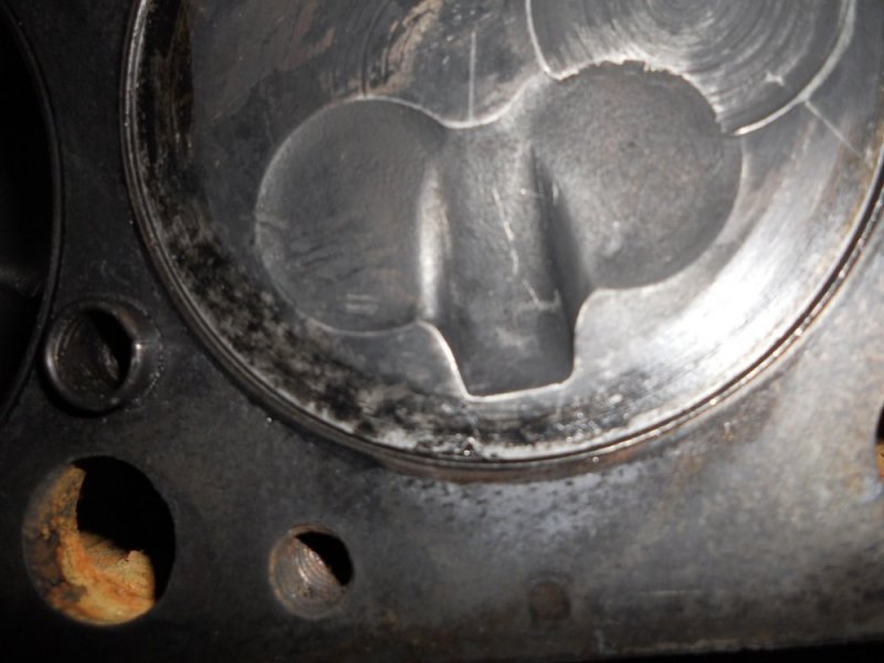

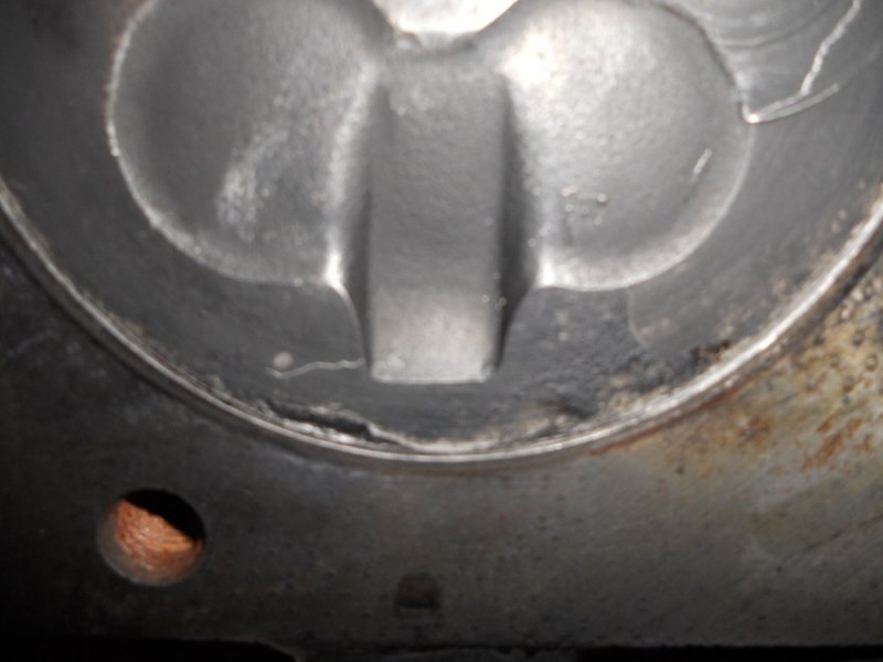

As I am my own warranty station I only use ether on a 6.2 and 6.5 engine I feel I can and will replace. For example to start one that already has a hole in a piston to get it on the car trailer. The pics below are mostly from a single ignorantly abused 599 block 6.2 engine with the melted pics from another engine. Cheap scrap metal parts is why I have it.

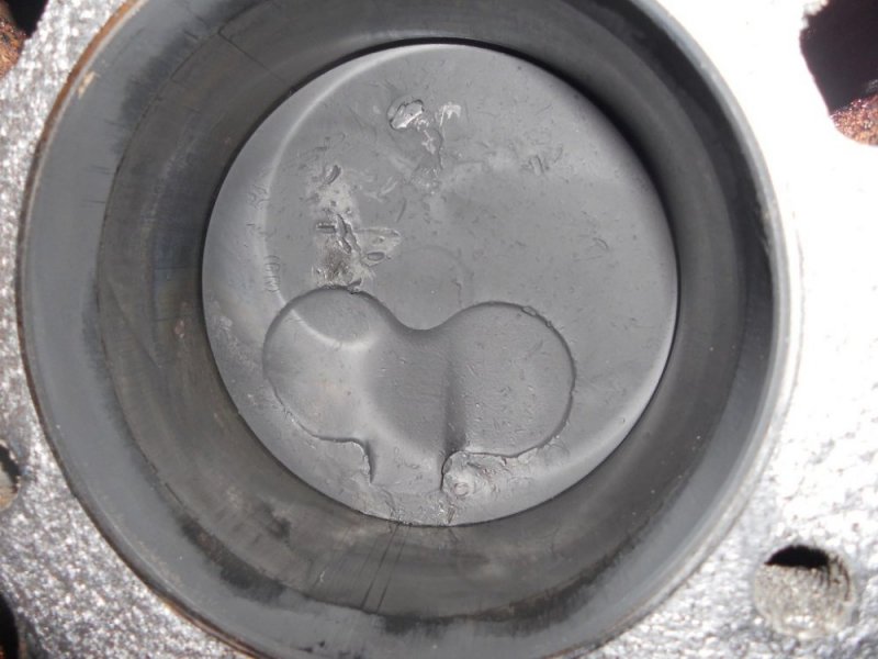

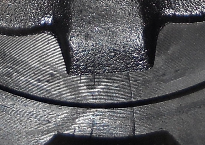

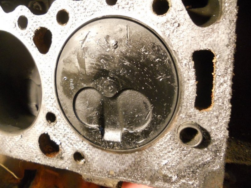

Of course someone uses too much and pistons crack.
Habit forming use example of too much heat. Melted pistons.

Most of those warning labels say not to use ether/starting fluid with glow plugs, not to not ever use it. Ether can be nasty stuff when improperly used, but it doesn't always cause damage. I still remember when it was common place to have ether injection cold start systems factory installed on diesels. Early 5.9l CUMMINS at one time had them and no grid heaters in non light truck applications. Ether, starting fluid, brake cleaner, and most any other highly volatile chemical with a low flash point can do some serious damage when it comes into contact with a glowing hot piece of anything. As to your pictures of the melted pistons, thats not from ether/starting fluid useage. I've got 5 pistons just like it in mine, and it never seen starting fluid. That kind of damage as well as most of tge hairline fracturing is from hot spots or where un misted diesel hit or sat. Notice that damage is all at the bottom where fuel would sit and puddle, what normally happensis you get an injector that leaks/drips, some fuel dribbles out when the engine is off, it settles at the bottom, then when it starts and that puddled fuel ignites, it burns like acutting torch instead of combusting cleanly, and burns the bottom of the piston crown or causes the cracks from the extra localized heat.

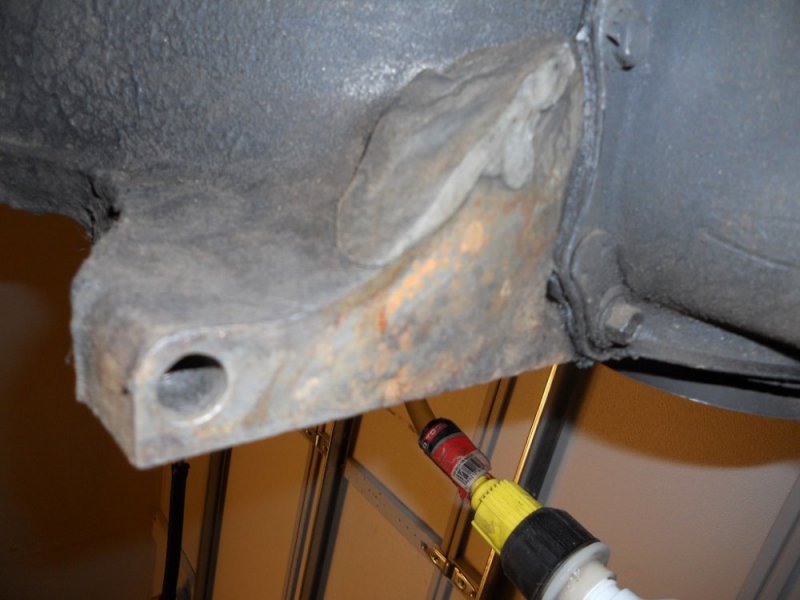

Apparently the first ether injection hole wasn't big enough for the prior owner(s) so a second bigger hole was made and are now plugged with bolts. Notice the engine is missing from the above picture! It's the one that had the melted pistons above aka from the project truck of mine. The CDR hole alone would have been a better choice... Sure there is more than one way to melt a piston. :woot:

I have 5 matching pistons to your melted ones that never seen the stuff. It's not to say your engine didn't also have bad injectors, hence why they were using the starting fluid to start it in the 1st place. I don't remember mine having that sticker on it, could have sworn it had the same one all the tractors I've ever worked on had where it said not to use it in combination with other starting aides. LOTS of people use starting fluid with no problems, you just have to use some common sense to use it. Some engines just don't want to start even with functioning glow plugs in the cold, but some proper use of starting fluid, and away she goes. Or you know the engine is tired, but you don't have the money to pull it right now, so you cheat to get it popped off cold.
