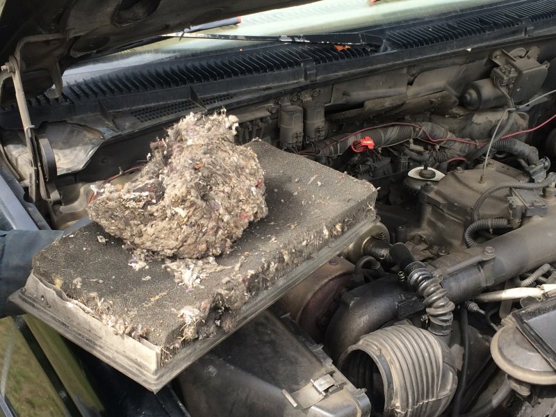

On the air filter restriction question: Pull the air filter out and give it a test run. Before someone jumps on me and shoots me for causing a nuclear meltdown in his cylinder walls from the gravel that will not be stopped by the missing air filter- a test run as in a mile or two without the air filter, not drive unfiltered for a day. You will know immediately if there is a restriction.
For a possible air restriction, you might want to take a look at the inlet to the air filter box in the fender.
Sounds crazy but it happened to me last weekend. I checked air filter and looked into the air box when I bought my Yukon about a month ago and didn't see any problems. Last weekend I pulled inner fender and air box off to replace the injectors. When I pulled the air box inlet out of the fender, there was an old rats nest + a big mud dobbber wasp nest inside the fender that you couldn't see with the air box in place. Air into the air box was restricted down to an opening about the size of a golf ball.
When I bought the Yukon, the guy I bought it from said it came from his cousin and it had been sitting for a while. I don't know how long your suburban was sitting before you bought it, but you might have a blockage like I found inside the fender at the air box inlet.
I thought I was the only one. I ended up fitting a piece of hardware cloth there as rodents will move in and clog the area in a few days with acorns, bird seed, or chewed hood insulation.
One of Bill's customers was complaining about underpower and smoke. Balked at the suggestion of air restriction. After a few back and forth phone calls he decided to prove Bill wrong...NOT.Mouse Nest 1.JPG
Thanks, for posting pic. Makes me feel not so bad. The only pics I could find was of interior damage from vermin.
