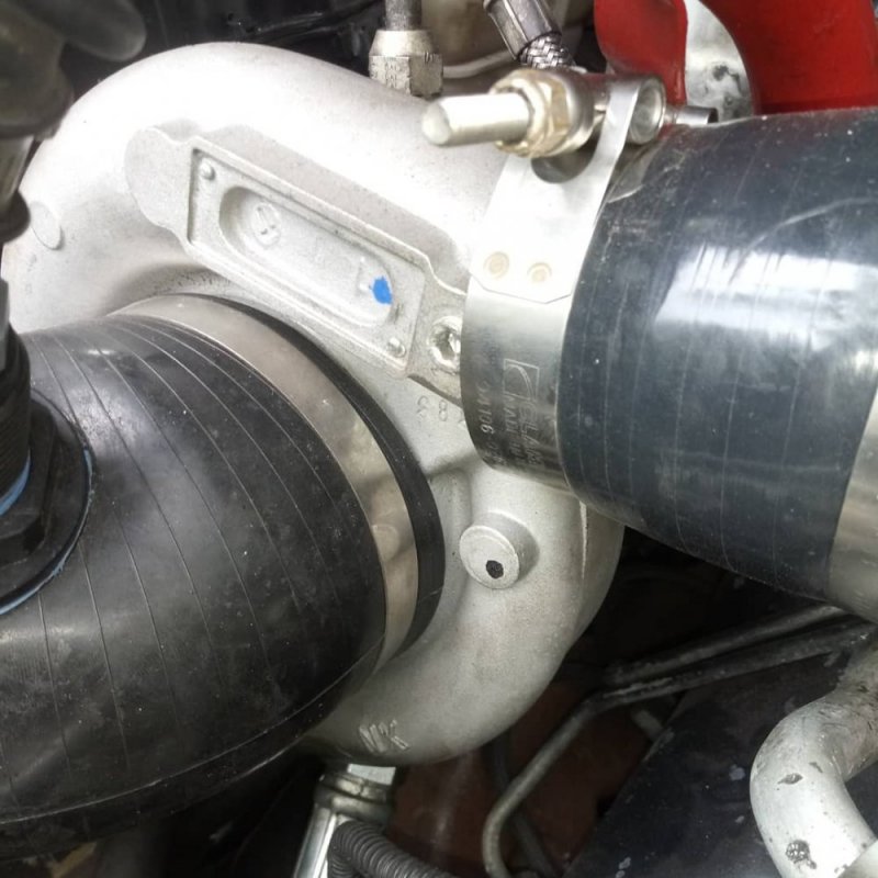

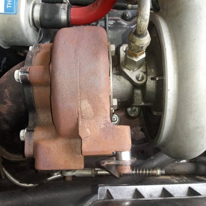

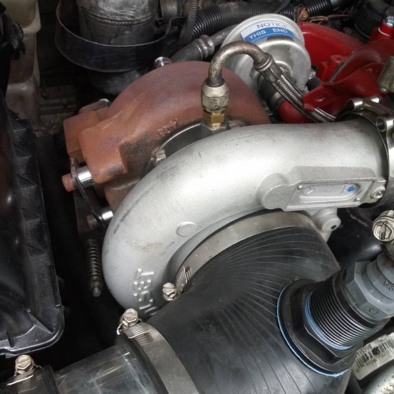

6.5L Super 54 turbo
Not sure what you mean but this is a super 54 turbo from quadstar tuning
Not to ruin your day "that looks to be some hybrid." Having hands on "LARGE" Holset turbochargers "I can say without any reservation whatsoever the compressor on that turbocharger is not a compressor from any of the 50 series by any stretching of imagination or description." 50 series compressors are larger and have a distinctive large reinforcement block cast into it between the outer edge of the compressor body and compressor outlet.

OK! I now know this is a custom turbocharger with its own nomenclature designed around the Holset turbocharger for the 6.2-6.5 GM diesel.
I am sure that it a sound design and well worth the $$$$...........for upgrading the GM 6.2/6.5 diesel platforms.
Looking at what specs are posted by them, what is the "54" referenced to? Compressor size maybe ? Wonder why the cover ID tag is removed? The specs are close to a HX35 but a little smaller compressor wheel it looks like but no wheel specs I've seen...

From what I've been told by john the super 54 is 100% holset. Its basically a hx35 with a 14cm gated turbine housing. He just didnt use an off the shelf turbo. Its put together his own combination of parts because there are a few different wheels available for the hx35.
Honestly; I was confused at first because Holset 50 series and PRO series do come in small turbine sizes too but the compressor is massive....I finally caught on to the custom build and nomenclature used to identify the turbo............"old age I suspect."
This is all correct. There was never any big mystery around this turbo. We only concealed the details that make it out perform the Cummins HX configs and the knockoffs. It'll walk circles around the 52mm "HX40WII" or a generic HX35 swap. It's all brand new Holset parts except the comp wheel which was custom.
