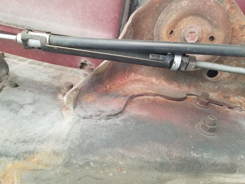

Hi,
Can somebody do me a favour and snap a picture of the bracket/cables located on the driver side forward rear spring mount on a late 90's Suburban. The E brake cables pass through and mount to this. I reconfigured this to a different cable setup for my rear disc conversion and am making changes again that require going back to the original cable set up. I know that given five minutes and scratching my head ill figure it out but an easily taken picture is worth a thousand words and all that.
Cheers
Nobby

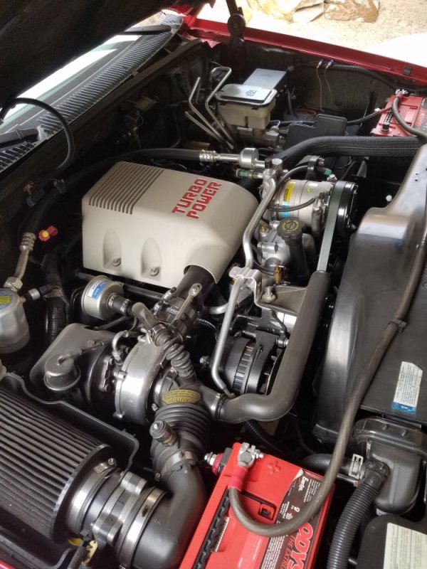

@Wreckinball67 Thanks for that, slightly different to the burb but i get the jist. That is indeed a clean truck!
What brake set up are you running back there?

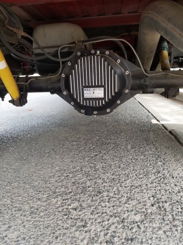

Stainless Steel Brake Corporation (SSBC) rear disc brake conversion.
To ak, yeah it's kinda of anemic in stock form, I have all the parts to make it into a "F" VIN setup just haven't got to it yet.

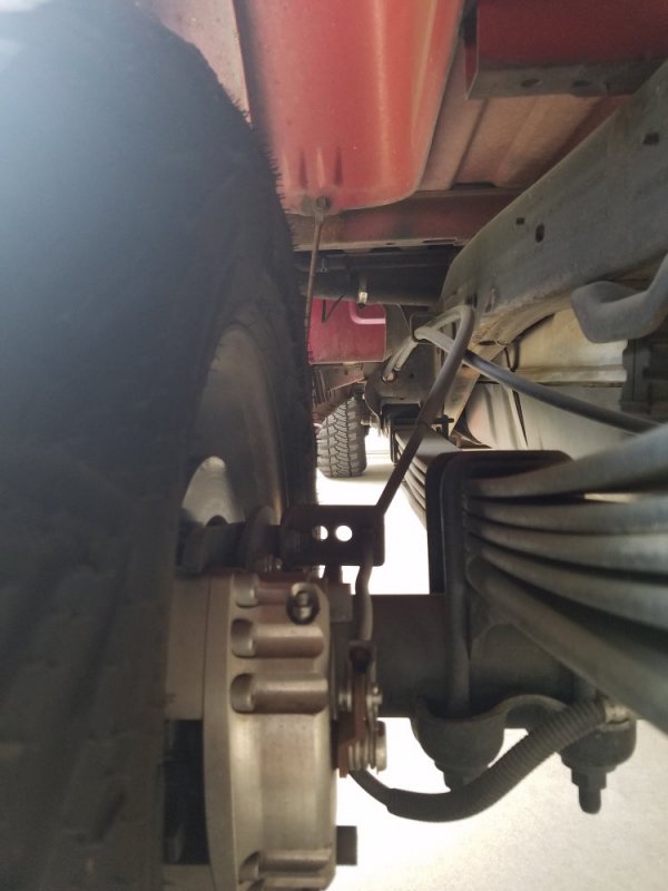

I have a 1998 K1500 (6.5 diesel), hope this helps.View attachment 62065View attachment 62066

They don't. I have a 91/2" semi-float rear end.

Yeah, but I did not see a kit offered for the 14 bolt semi back when I did my conversion. Cannot find it on their website now either unless I'm going blind or something!
No matter I'm married to the TSM kit now anyways.
You are correct, I just ordered kit for the k1500 (which is what mine is) and slightly modified the brackets for the larger axle tubes.
