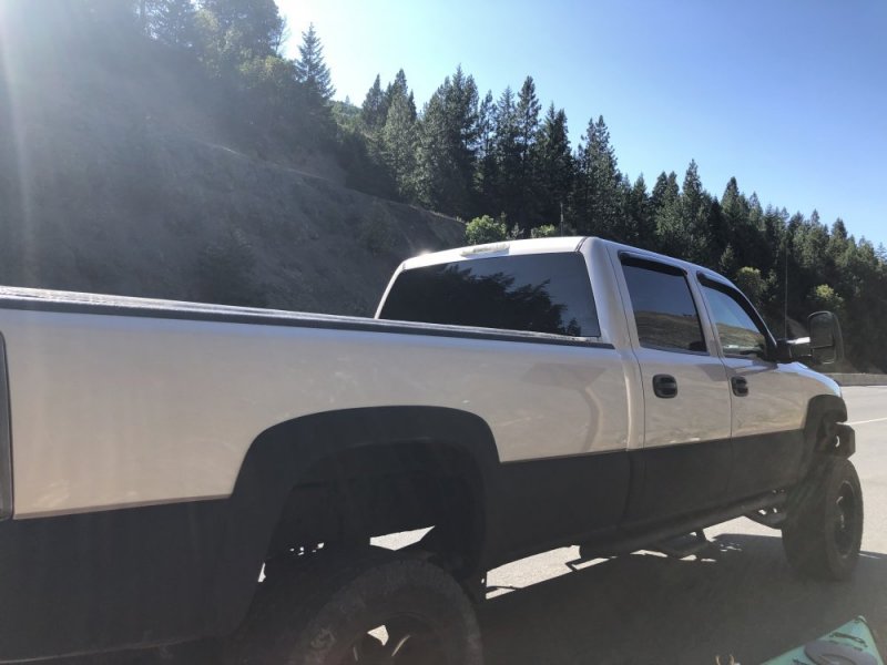

Stuck on the side of the road again...

Hi Guys... thank you all for your insight it Is appreciated.. ended up replacing the plug and re-enforced it with a bracket but I do like the Indian Head Shellac idea.. also realized the fan clutch wasn’t engaging so replaced that and replaced the radiator as the asshat before me filled it with stop leak.. she is running and sounds a lot healthier now and the test run with the toy hauler will happen soon.
