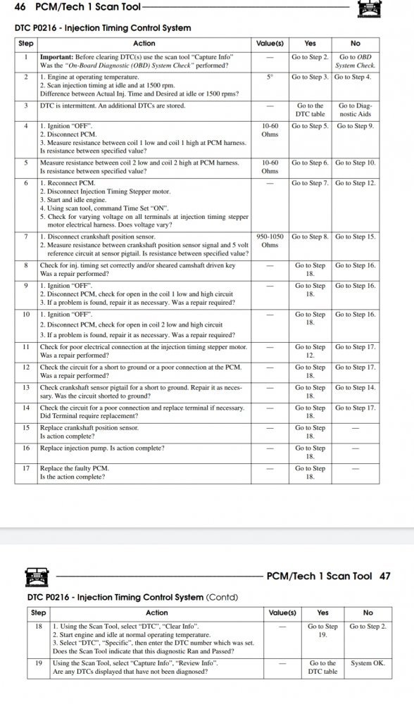

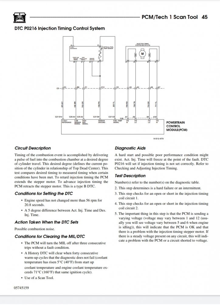

Thankyou to everybody that replied,.. truck is a 99,.. i have a code reader it cannot perform any sort of test,.
I will have a look at the stepper motor,. and the connections to the crank sensor,. i will warm it up again and then see if disconnecting the ect sensor makes any difference,. it doesn't make any difference on a cold start,. and i will try the ohm tests that i can see in the chart,. i do have another pump i can install,.

Thankyou denata for your diagrams and troubleshooting charts,.

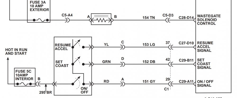

I pulled the ecm out to look at it,. somebody has been there before me,.small brown plug B11 dark blu wire has been cut and another wire added,.
bigger brown plug D10 grey w blk stripe has also been cut and a wire added,.both wires go thru the firewall somewhere,.to somewhere :droid:
I have been searching for a pin out chart so i can see what these two wires do (go to) can anybody point me to a ecm pinout chart for 1999?
