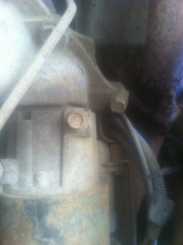

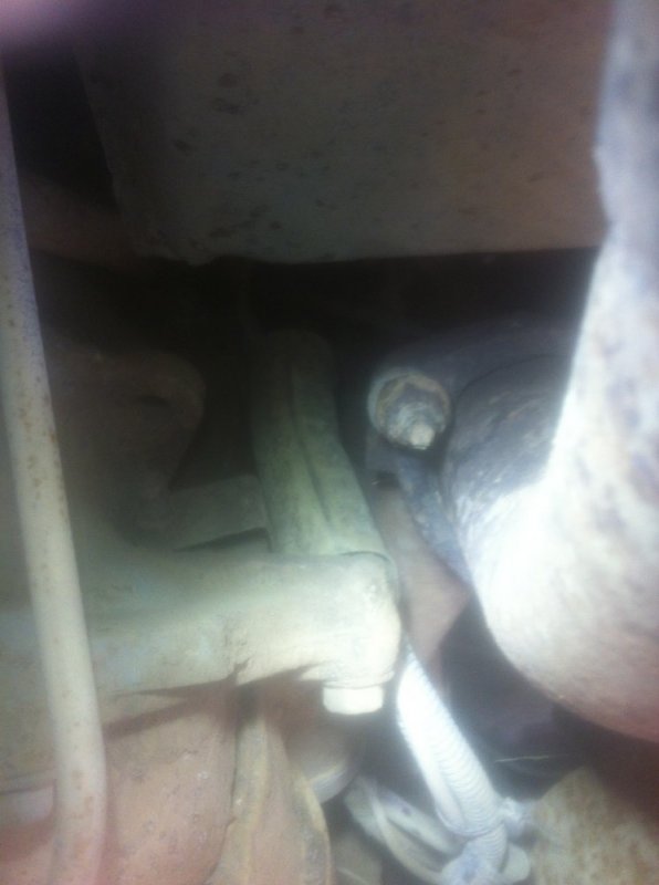

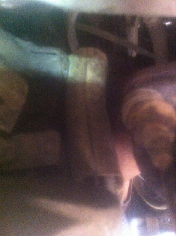

Hello Will, MrMarty,Warwagon and everyone else. I've been away for a long time but hope everything has leveled out with me now. I'm back to finishing the 96 k2500 Silverado after an almost complete re-wire job. There is a metal heat shield that bolts somewhere around or below the exhaust manifold that is driving me nuts. I can't for the life of me figure out how this thing attaches. I have turned it 12 ways to Sunday and can't make the holes line up with anything on the engine, bell housing or frame. When I removed the tranny it was just hanging on the starter cable. Can anyone lend support?

Are you talking about the heat shield between the starter and the block? about 10" long by 3" high? If that is it I can take a pic. tomorrow as I am installing my engine.
Mine is about 4 inches long by maybe 2 inches high. I better say the heat shield is those measurements instead of "Mine is". Don't want people to think I'm bragging you know. It also has a little bit of a crooked bend which in the middle, not much of a croock. AGAIN, I'M TALKING ABOUT THE HEAT SHIELD GUYS!!! Thank you sir, a picture of your heat shield may point me in the right direction and I would really appreciate it if you could do that. Have a great evening, Richard.

Sorry buddy, I forgot to addine is a gas job. If you will please post a pic. of what you have. Long story behind this truck. Thanks again for your help, Richard .

Here are some pics, they aren't very good. It bolts to the bottom 2 bell housing bolts

Well now, that gives me another place to turn this thing 88 different ways. Man you have certainly helped me out. I will try to finish that part and the exhaust tomorrow. I've got to complete at least 2 so I can park something else in the garage.
