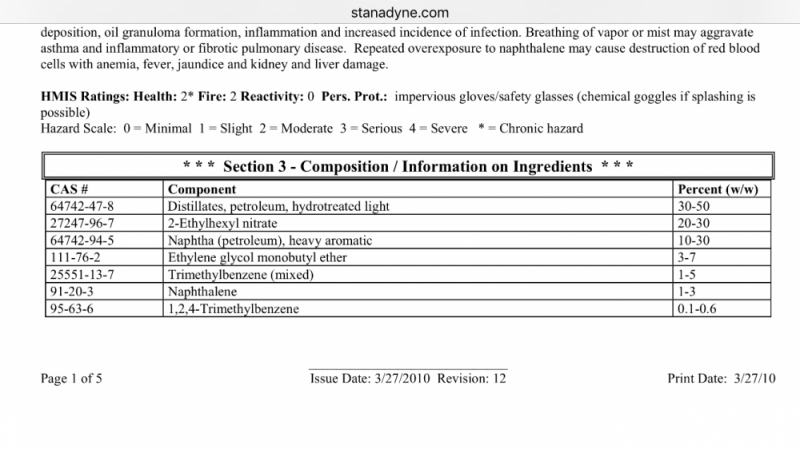

So everything on the list is basically oil, gasoline, solvent, cetane booster, and junk to get a low flashpoint so it all burns away instead of leaving deposits in the cylinder. It is all hydrocarbons from crude oil when they are making fuels.
Thanks to the msds we know most everything in there...
Hydrotreated light distallates is oil that has underwent some process treatment of water- if I had to guess it is the same treatment that is done to engine oil-It gets heated to 400-600 degrees f in the absense of oxygen, gets flash cooled with water to crack off the shortest part of the hydrocarbon chain, then is reheated to 195f where the water and oil naturally seperate. We dont know he viscosity of this oil to start with, but my donut is bet against 10-12wt.
Next is 2 Ethylhexyl nitrate which is a cetane booster. Basically any fuel additive that people add and notice a drop in power they think doesnt work, so this crap is added to keep sales up, but it would work better without it truth be told. At least this is hydrocarbon heavy and not corn alcohol rich junk.
Naptha is c5-c10 just like gasoline, but is not a full refined product. So it will mix well and is more hydrophobic than gas. If it is sitting in a jar on he table, you would think it is some old gas by the feel and smell- which could be a bad thng since this is where the h2s (mega deadly gas)hangs out.
Next is EGME more commolnly EGBE is a cleaning solvent. It is what is turning into the goo when all the realky flammable stuff evaporates. It is just the cleaner in there. Same solvent, aka friction modifier, that is in your atf.
Trimethylbenzene is getting so light in the hydrocarbon chain that it is closer to propane than gasoline. It is cut back into gas because it helps it ignite easily. This one puzzles me why it is in here unless the cost of seperation just makes it better to leave it.
Naphthalene is super gogo juice, high power additive. Any oldschool guys that knew to soak mothballs in the gas tank- this was what you were adding. No friggin way they are adding this in on purpose, its too expensive once it is seperated, they just cant get it all out.
The last item is basically same as trimeth above. Its toxic crap so they list it, but they just cant get it all out. This small of an amount is not going to make any impact.
Its good stuff. I like engine oil, atf, and if I add too much, then a cetane booster. Buying this stuff just gets all the levels exact and doesnt leave a puff-o-smoke at the stoplight under hard acceleration.
