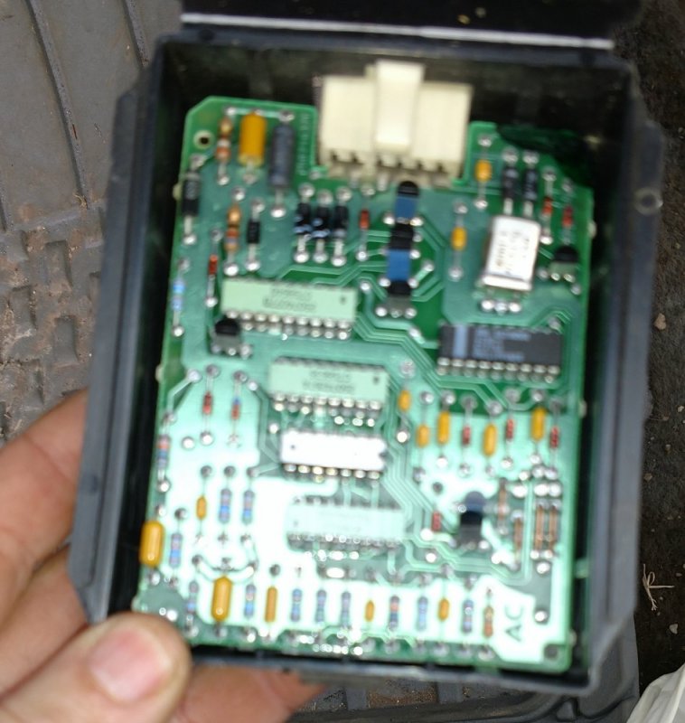

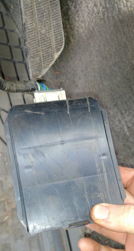

Any body have any idea what this is, I'm a older GMC guy, first Fuel Injected older truck. (87 GMC Suburban).... It was located inside the dash just above the gas pedal. Redoing the dash, just trying to figure some of this stuff out. Thanks for any info.

I seen a box like that, It was mounted to the steering column of whatever it was I was working on. Possibly My 2000 K3500. dont remember its purpose though.

Chime is on the relay box to the right of the steering column . It has the blinker and some other stuff . The wiper delay is the one with the ribs directly under the steering column when you take the small plate off the lower dash panel . I think what you are asking about might be cruise control .

Cruise module , slides up into bracket by brake pedal . Couple different numbers but 85 - 91 diesel 25110882 . 85 - 91 gas 25110868 .

Thanks for the info!
