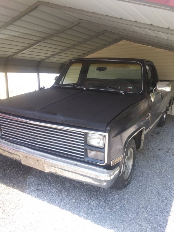

Thanks alot. After years of working on chevys and not talking an alternator apart for fear of the brushes flying everywhere I tried the toothpick trick about a month ago. I hate to think about the good alternators I've trashed over the years because of that. Now if I can figure out where to attach the carb end of the kick down cable from the transmission I might get to drive the thing.lol I bought it to sell but fell in love with this old truck. Forgot what it was like to drive something with real power and boy what a smooth ride! It's worth losing a little ⛽ mileage. I really like this forum too. Too bad it wasn't around when I got my first truck.
