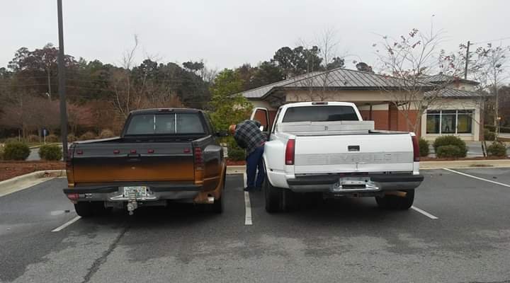

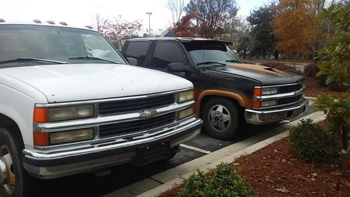

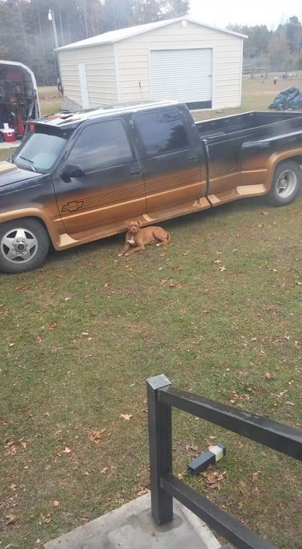

The paint job....well, its black faded into gold. Eventually it will be pearl white faded i to 73 porsche royal purple...lol.
Im going to eventually regear the 4:56 with 3:73 or 3:90. I dont really need it to pull anything except the tractor once in a while if sour cream(96 chevy 3500 vortec 454) is down. I dont really want speed out of it either(faster than 52@2500 would be nice though...lol).
Might sound stupid, but, i love my truck and plan to show it some day. I got it from the org owner that used it only to pull his cattle trailer from pasture to pasture. 100% no rust anywhere, 95% perfect interior, 123k on it now. It is just like me, short, fat, slow, ugly, and a workhorse....rofl hence the name potato
Pics are the potato next to sour cream and the potato with tater tot next to it....lolFB_IMG_1588651069708.jpgFB_IMG_1588651082110.jpgFB_IMG_1588651099379.jpg

Nice lookin truck- I like dropped dually for on street use.
Welcome to the Forum. Good looking truck. I see you found the cause for the CPS code. Chasing an issue there myself so figured your belt breaking apart might be the cause. Rock Auto is still a good source for parts that the local shops don’t carry. Especially electrical connectors if you’re snapping off retention clops. Wanting to show it off in the future and all, there’s no extra points for matching zip ties holding things together.
