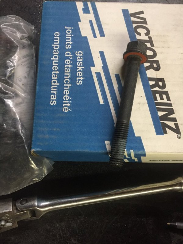

11,275
14,416
What do you think about the oring mod at the top of the head? This is the one issue I have any fear of when I redo my optimizer. All the other stuff just do it by the book and ya don’t have to worry. TTY known failures and proven to cause so many of the headgasket losses vs arp known leakers. Smh.
How friggin hard is it to not have wet holes in design?!? Rant not over just on hold for now...
Gonna do anything else inside this engine different while it’s apart? Gapless rings, coated bearings, etc?
Husker6.5
2,460
2,540
Lincoln, NE
Just have to brush on LOTS of Teflon sealer on those wet hole ARP studs! Seems everything is a compromise of some sort on these engines.
I don't think I'll do anything different other than be more liberal with the Blue Loctite. I only put a drop on them the first time.
This truck is only used for work anymore and doesn't see many miles.
WarWagon
Well it hits on 7 of 8...
9,352
4,806
I also tighten the studs into the block by using a double-nut arrangement. This allows the lock tight to do it's job better. The risk is dimple of the block around the stud. So be careful as to how tight. I got them as tight as I could with a hand wrench. YMMV.
Yes, coat the ARP studs in lock tight like you don't want to see em again. I run them in a little, back out some and in the rest of the way to help coat everything. Seriously I used Red... They are never coming back out. :jawdrop:
The Oring to me is a waste. You don't want it to get past the block threads. If it does you already lost the battle.
11,275
14,416
The tty bolts even use a sealer on the bolt head flange though. GM new some gets past the theads, thats why they do it.
That is why I’m thinkin about the oring seal idea. Just thinking how hot does the head surface get and what is that oring going to withstand.
I agree 100% seal at the threads is what is really desired. I want some crap that seals up nuclear power plant tubs, ya know? Haha
