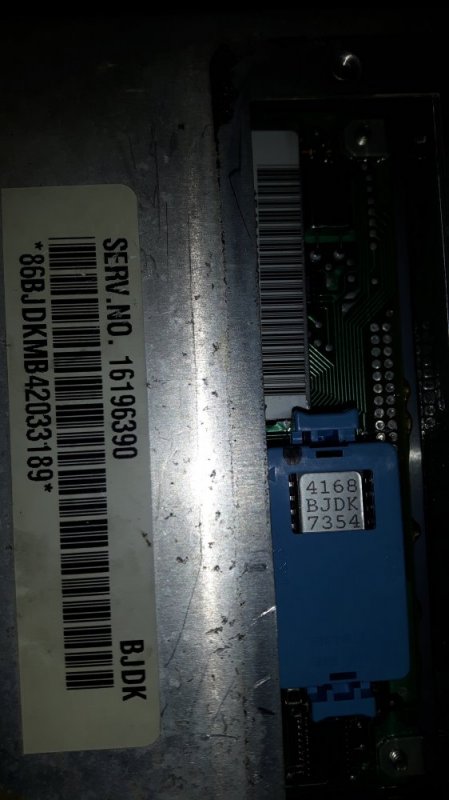

Here is what I see.
EWC
399
387
So that's a TCM from 94 - 95 van . That's a little different than the 91 - 93 TCM 16147609 . Thought it was just a faster baud rate , maybe Ferm will know . How much are you asking ?

Its the exact tcm from the Bobby Martin guide. I actually bought it from bobby himself. I paid 100. Make me an offer. Its just sitting here.
THEFERMANATOR
FRANKENBURBAN
Staff member
Lead Moderator
10,531
5,577
ZEPHYRHILLS FL
The difference is probably in the output speed sensor. The 91-93 ECM had the output speed sensor of the trans ran directly to the ECM itself whereas I believe the vans read from the VSSB.
