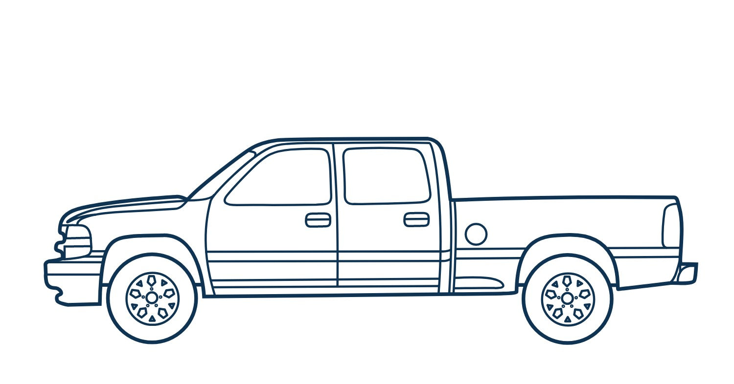

Looking for an easy mount pre-formed rocker panel to cover the sins made by road salt treatments. Loking for the rocker panels that I can install without having to spend a ton of money at a body shop. Need to cover big holes.
I have searched the net but cannot come up with what I'm looking for. I need the skins, to go over what is left of my rotted rocker panels. Just need a few more years out of this truck.
2006 Silverado Crew Cab.

This anything you would be interested in?
