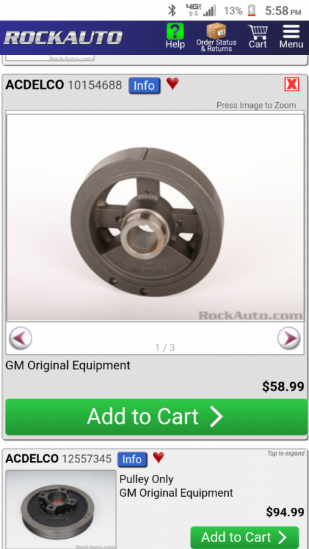

Rockauto shows AC Delco # 10154688 & AC Delco # 12557345 for the pulley.. Both can be found on ebay if RA isn't going to work..
Also with the correct part numbers any parts store should be able to get them.

They both are on ebay from several different sellers and that is the correct part numbers...
Keep in mind you should have a balancer puller & installer tool to do the job without risk of damaging the crank threads.. the crank bolt size is M16X1.5, most rental tools won't have that size adapter..
