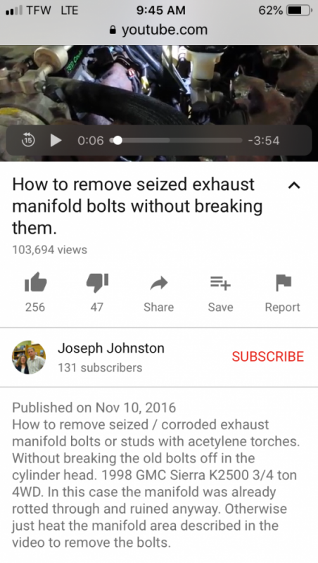

I can’t tell if they are bolts or studs. I found a YouTube that is pretty much like what I have. I would love to do it because the noise blows but it’s driveable. If I mess it up, I am screwed. I am having a hard time finding what to use for new bolts/studs and there seems to be a disagreement about using gaskets.
It would not let me direct-link the video.
