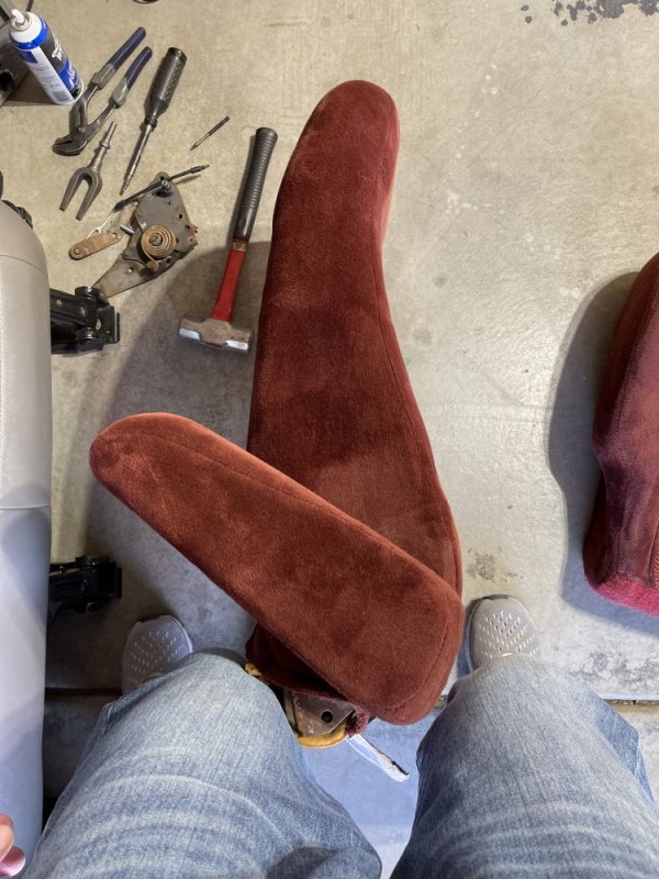

It takes maybe 5 seconds to get it off
The working ones maybe. The high effort ones... :skep:
30 min later it still would not pop in with a hammer, tire iron, etc so it could move backwards. So I used a blunt hammer to smack it backwards.
Then I pried on it some -about half an hour.
Then I got a pickle fork out and beat it into submission. :mad2: It finally came out of the seat.
I then sanded the rust off, used a battery post cleaner brush in the seat, greased it and put it back together.
Works fine now. Why it was rusty I don't know.

You do have to get a feel for it, but I can get mine off in maybe 5 seconds. Today it was so nice not having the binding and the sqweek when I moved it. On the Suburban 92-94 anyway they have armrests on both sides of both seats.

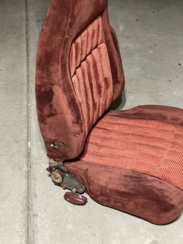

Google led me here, thanks for sharing this with us, it saved the day for me. I did have to pull the Velcro tabs apart at the bottom of the rear seat cover. And had to pull the zipper up in the back to allow me to put some Kroil in the hinge pin/socket area and soak for an hour. After that, the armrest that was giving several of us a very hard time, came right off. It does take a huge effort to get the armrest pushed in far enough to get to the large hole area, if there's any corrosion inside ( which is to be expected for a 94 model I have owned for the past 17 years).

Just found this write up that is quite old. Trying to fix a seat now and armrest is back but won’t pop off. It’s about 10 o’clock position behind seat. Doesn’t move farther and could feel it go through tighter area. How the hell do you pop it out?

(10 years ago) If I recall they could be rusted so you may need to work it/twist it out. Some lube if you can will help.
