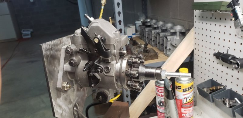

My issue with about every pump builder out there is not one of them puts out a product that truly upgrades ALL the areas of the pump. Conestoga is the worst, R&D & CCD do a better job. But even they drop the ball on ULSD upgraded parts.
The funny part about "hotrod" pumps is it only takes two spring upgrades... that's it to go from mild to wild. But calibrating the pump after these two spring changes is the key to unlocking all the extra fueling. But as you start increasing the R-R spec other upgrades are needed to keep the pump together. Mostly the cam pin, something only R&D and CCD offer at this time.
Besides performance upgrades, ULSD conversion parts in my opinion are a must on these almost 40 year old pump design. R&D and CCD are at least sleeving the advance piston bore. Which was an issue even before ULSD. But not one of the 3 builders I've mentioned upgrades the transfer pump or other areas to handle ULSD. I'm sure they would if you asked. But in my opinion that should be part of a standard rebuild. Worth the extra money!
Its because of this I have spent the last year doing research and development on DB2 pumps. I think I can put together a pump that is better than anything being offered even the NEW stanadyne units. The first prototype is coming of the bench later this summer.
To be fair to Conestoga a little what happened to Spdgofast's pump may not have been their fault. There is only 2 ways to build a .350 8 cylinder pump. 1. Increase the plunger bore. 2. Swap a .350 rotor into a 8 cylinder head. The 1st way I've seen ZERO success getting it to survive. Not a single pump has ran very long after the plunger bore was machined. The 2nd way is possible but the H&R are a machined pair. So finding a .350 rotor to properly fit a 8 cylinder head would be a challenge. If I was was to build a pump with either of those two modifications it would be hard to offer a warranty because I know that there will more than likely be an issue down the road.
But building a standard "Hotrod" pump should definitely come with a warranty. Because again its just 2 springs being changed. And if the builder is smart a upgraded cam pin to handle the extra fuel.
