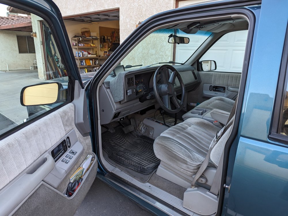

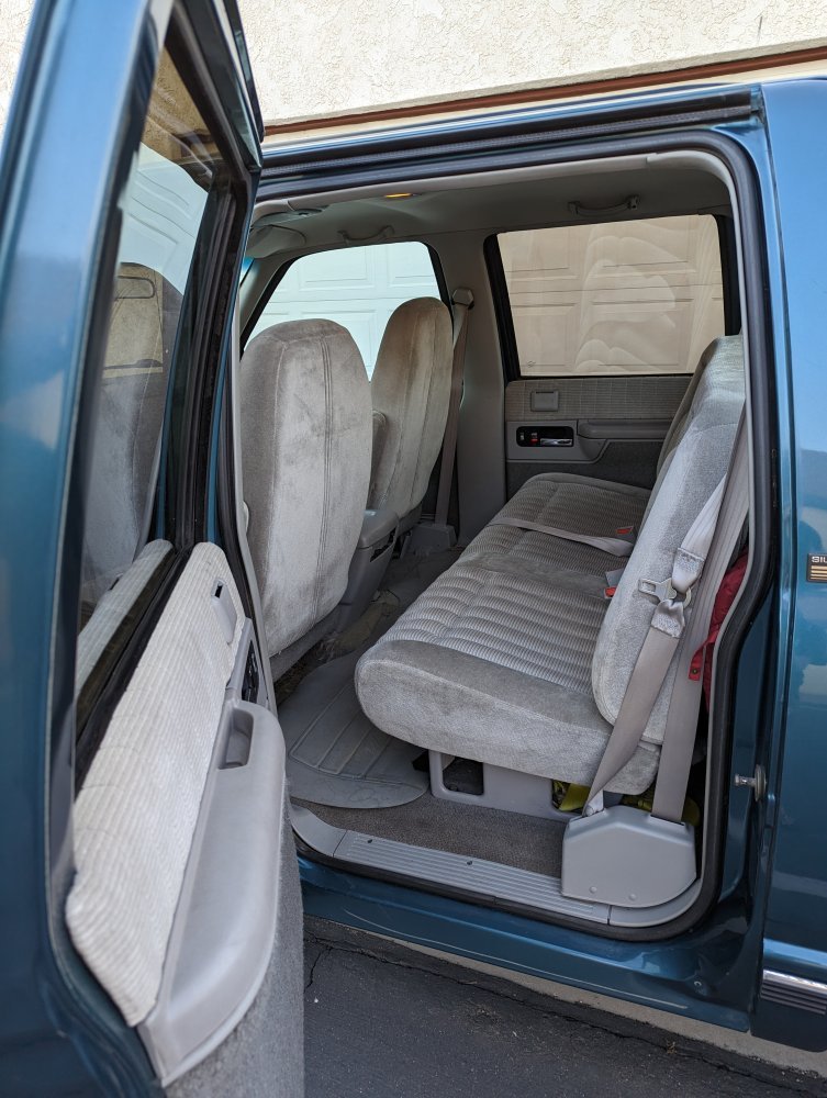

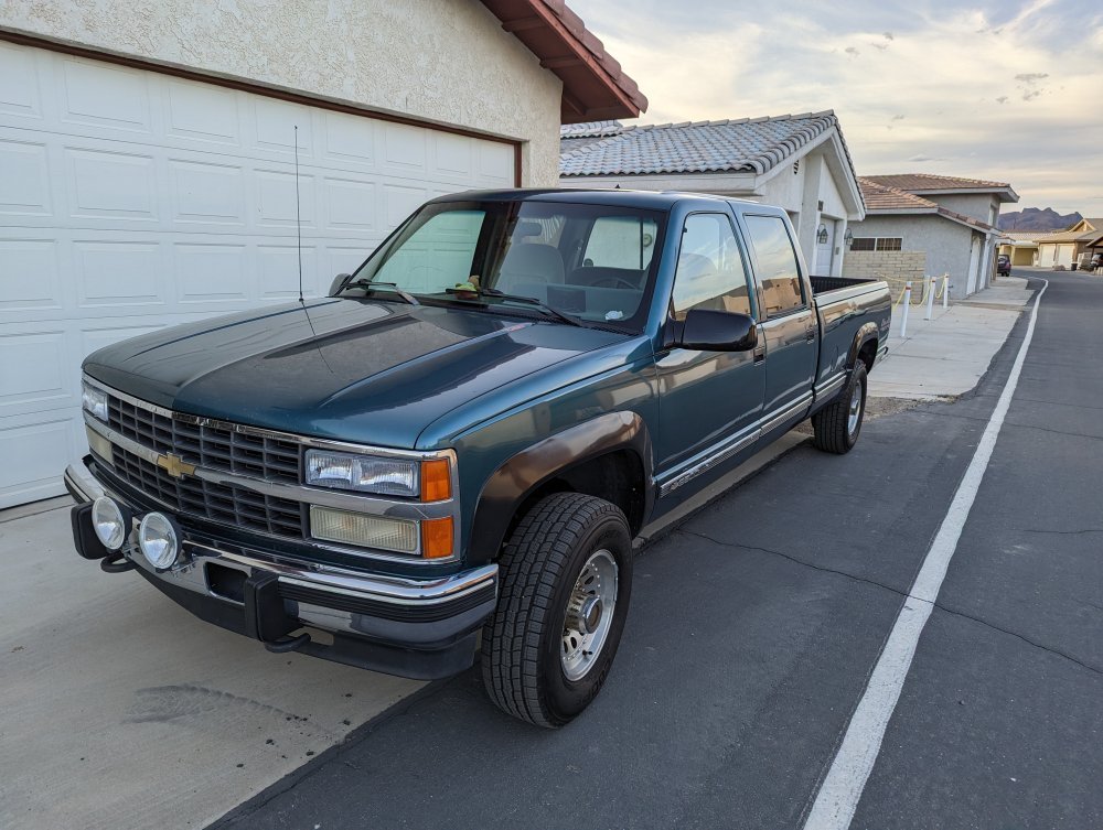

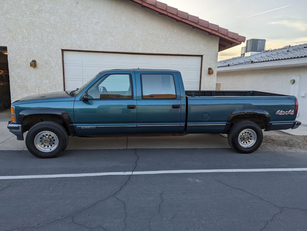

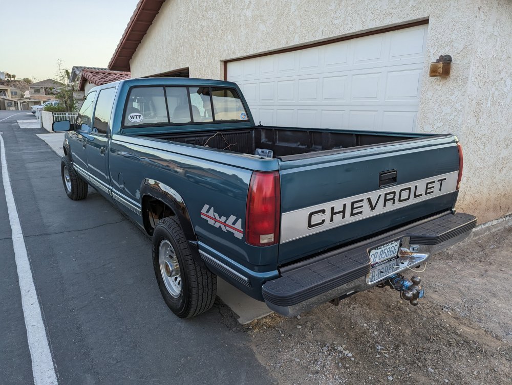

Could You please get a several pics of this truck ? To hear of one in such pristine condition is rare, if at all.
Maybe we could smell that new/old stock truck smell that it came with from the factory. 🤷‍♂️🫣😹😹😹

Regarding photos of my truck, I have several on my phone, but have not yet figured how to post them here.
