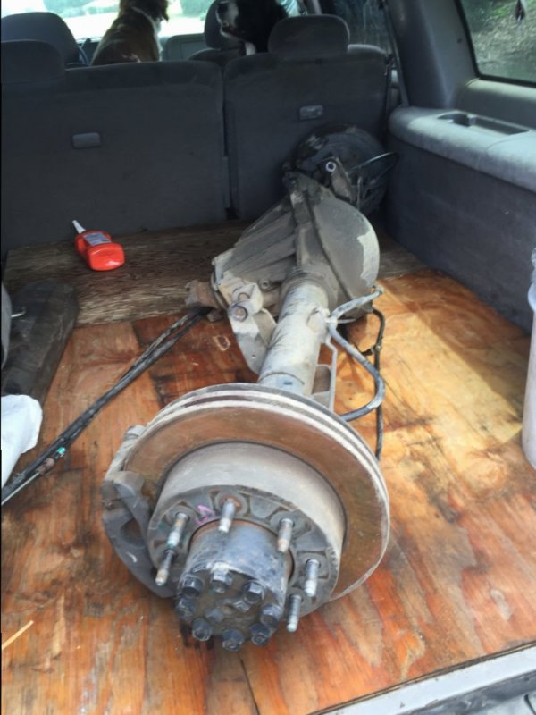

Judging from his pics, my guess is he's doing an axle swap. 01's have an internal drum style parking prake, and I see he got the cables with it for them.
Good eye there Ferm. I cut the parking brake cable ahead of a splice that was ahead of the "Y" where the cables split to both wheels. I'm hoping to splice the existing cable into this set-up. Otherwise, not sure the existing would match up with this set-up.
I measured the OD distance on the spring perches and they're 2" wider than our existing. So they'll have to be cut off and new ones welded in place. I'm told the perches for the rubber snubbers will similarly have to be moved. I'm also told that these axles have a 2" wider track than the GMT-400 models. Haven't taken a tape to that.
Total for everything was $300. I looked into disc brake conversion kits for our GMT-400 axles and they were $400 to $500 for everything. That got you single piston calipers from a 1980s Cadillac Eldorado, with or without parking brake.

Don't know if it is or not. Haven't worked on a new style yet to see if it is or not.
I went out to compare. Both have similar square, 4-bolt mounting plates. The drum brakes mount using bolts from the outboard side; the disc brakes mount using bolts from the inboard side. If those plates are the same size, it might be possible.

Even if it doesn't, what if you modify the 4 bolt flange to work. Have to cut and weld anyways...
This is a project in the 6 month time frame. Plenty of time to figure it out.:happy:
First project is the GMT 800 brake conversion.

I did some quick measurements of the end mounting plates this AM and they're completely different. GMT 400 is a 4" x 4" square and smaller bolts. GMT 800 is a 5" x 4" rectangle and the bolts are substantially larger. Check the inside width between the plates and the GMT 800 is approximately 1.5" wider on that measurement. This is going to be an axle swap.
