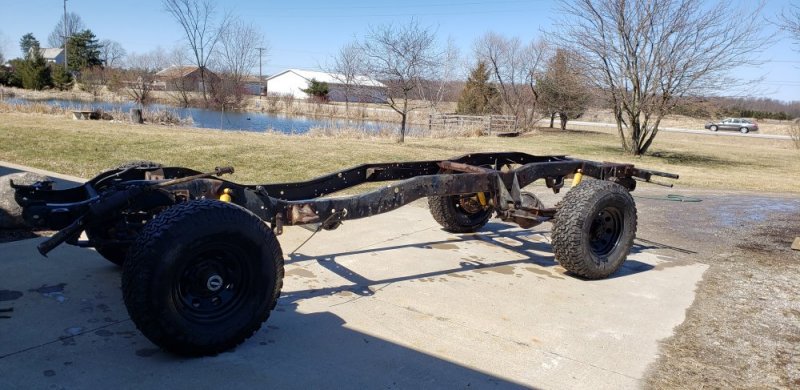

Got the motor. transmission, and transfer case out of the way today. Weather was nice so I power washed all the mud off the chassis. I forgot how clean this frame is. Definitely not from Ohio. Hopefully tear it down to bare frame tomorrow. The. Time to place my order with Offroad Design.

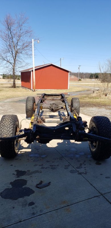

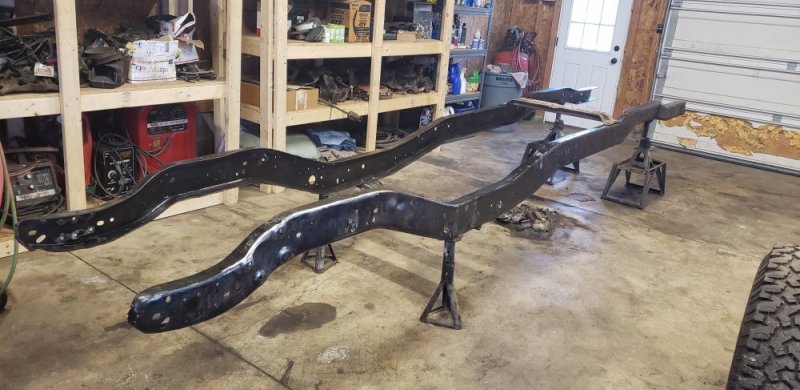

Made some more progress over the weekend. The frame is stripped down to two bare rails. I wanted to get all the riveted brackets off the frame to make sure everything was solid underneath them. So far there is only a small spot by the rear leaf spring hanger that needs some patch work. I knew that spot was there so it's no surprise. The frame will be getting new custom built crossmembers as well as fully boxed. All the rivets will get replaced with 10.9 shouldered bolts and nuts.

“Frame off” is a common term. “Frame apart” isn’t as common. Frame painted or powder coated and then bolting together with unpainted hardware always stands out as a very clean look. Boxing it in definitely adds to strength. Weight also, but worth it imo.
A lot of hummers have been getting done that way last 10 years now, as the entire frame is bolt together on them.

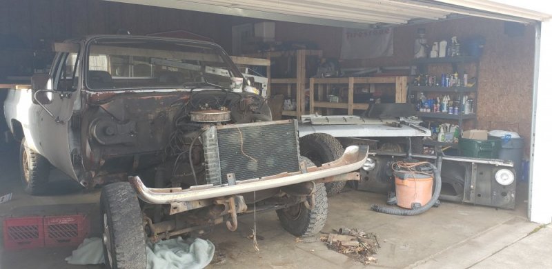

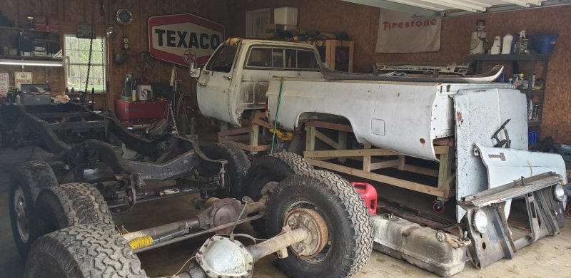

Made some more progress this weekend. Got the white 78 in the garage for disassembly. I'm on a roll with tear down so I might as well strip everything down and make a list of what I need. That way I can bounce back and forth between chassis, drivetrain, and body work. The weeks I'm waiting on money for more parts I can stay busy with cleaning and rust repair.
56568
The white truck is in good shape considering it spent its whole life here in Ohio. May be due to the fact the original owner was oil spraying it over the years. Also it had a light restoration in the 90s. The rockers, and cab corners need some work. But that's standard for these trucks up here in the rust belt. Both the cab and bed are in good enough shape to fix with patch panels. The fenders are aftermarket, and have rust along with the inners and core support. So I'm going to replace the front clip minus the hood. Then use part of a 01-05 Silverado core support so I can mount a lb7 radiator and intercooler to go with the fan and shroud.

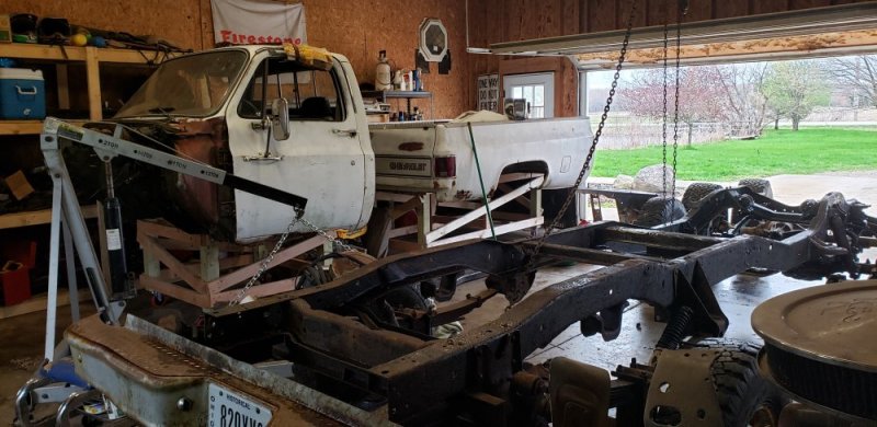

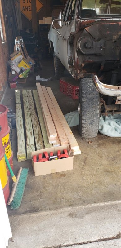

I got the front clip off. And have the cab and bed ready to pull off. But I thought to myself, where am I going to put these? So i took some measurements and ran off to the hardware store. My plan is to build 2 rolling structure to set the cab and bed on. That way I can move them around and make it much easier on myself. Plus If i need room to work on our other trucks I can roll them out side.
That's the plan for next week. I hope to have everything torn down and ready for metal work by the end of the month. The chassis and cab are my big focus for the spring. The sooner I get them back together the sooner I can set the engine in. Then mock up the up pipes and turbo. 😜

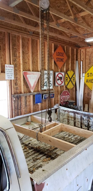

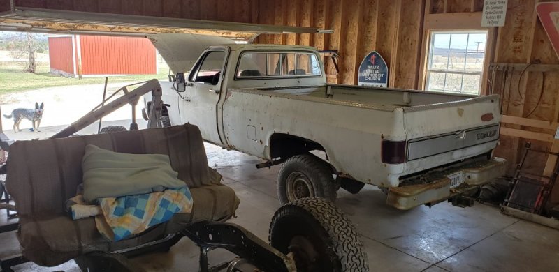

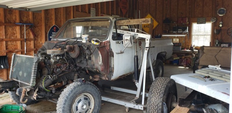

Over the past two weekends I continued to tear down the white 78. I built the rolling structures for the cab and bed. They are made from mostly 2x4s. Very simple and didnt cost me alot of money. And when I'm done with them I can use the wood to build something in our garden. I lifted the cab off with my engine hoist. I rigged up a beam with a u bolt to hold it from falling. It was a little front heavy but it worked. The bed I made a simple wood piece from 2x6s to fit under the bed rails. Then used my chain hoist to pick it up. I quickly found out my old chain hoist needs some work. But after a few scary moments I had the bed off and on the roller. I'm going to need a better process to do this after the body is painted but for now its apart and that's all I need for now.

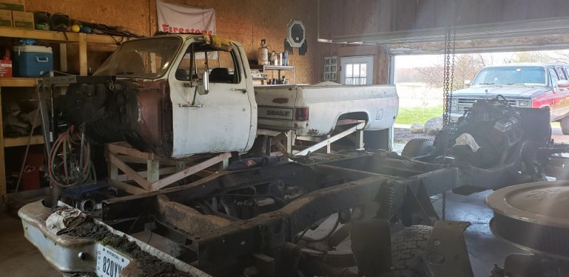

Once the body was out of the way it was time to get the chassis torn down. I removed the powertrain, and everything else that was bolted to the frame. Including all the lines and wiring. The original owner must have used a really good rubberized under coating on this frame. I used a wide scraper to remove the big spots. It was then I started to realize this frame is in better shape than I thought!! But this stuff is on there!! So after removing everything I could get to by hand I rolled it out side and used the power washer to clean the rest off. I had to use a 0 nozzle to even get this stuff to come off. The majority of it has been removed. But I still have alot of work to do to get this frame cleaned up all the way. I might end up using these frame rails with some brackets off the other to make a complete frame. Once I get the rivets out and this one torn down to bare rails I will know for sure. I need to take some measurements for crossmembers first then I will fire up the torch and get this frame apart.

I like the rig you made for pulling the bed. Clever.
