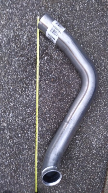

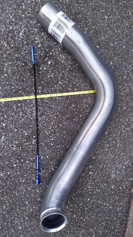

This project goal was to creamic coat a down pipe with the expectation to push heat under the truck and not have it radiate along the firewall and block. During the discussion phase, Twisted Steel recommended to just go with an internal coating as opposed to my thought of coating both sides of the pipe. Reasoning was that (for the exterior) wraps were more effective at heat retention, so I decided to do the wrap on my end where Twisted Steel was good with that approach (and would have done the wrap had I wanted).
Pictures:
Naked Pipe

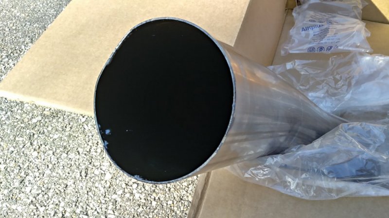

Finished Pipe

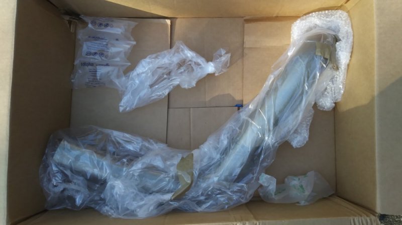

Turn-around time was within the time-frame that was provided at the start of communications. Am not stating the exact dates as it does not really matter where they may change for different customers and workloads.

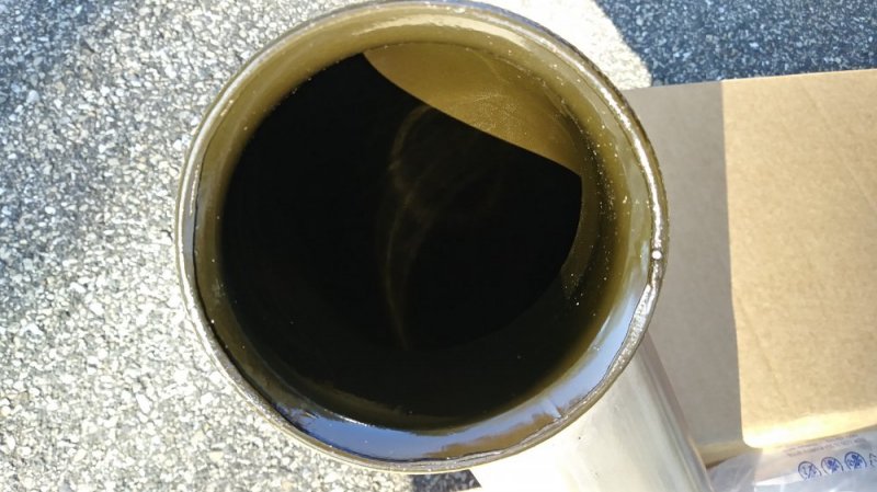

The quality of product looks good, and in fairness, I have nothing to measure against as I do not have any data from the old exhaust pipe. Even if I did have data from the existing pipe, the current exhaust is 3" with *no* heat retention treatment and I am replacing it with 4" that will have heat retention treatments, so it would not result in fair comparisons anyway.
I did notice that the pipe looked like it took a bump on the downstream / trailing edge and am not worried about it. That is what tools are for. In any event, this is the result of the shipper and *not* Twisted Steel as the shipper supplied the packaging and did the packaging on my end; Twisted Steel re-packaged according to how the shipper packed it.

The ID coating shown in Jay's pipe is the same product used in head runners and Chrome pipes, it's used in chrome pipes to keep them from blueing. When used in runners it slows and almost stops exhaust gas heat soaking the head thereby helping with cooling.
This same product is used in drag race motors in several places, it keeps the heat IN and is oil shedding and aids in oil drain back. This is a slick, smooth, hard coating.
