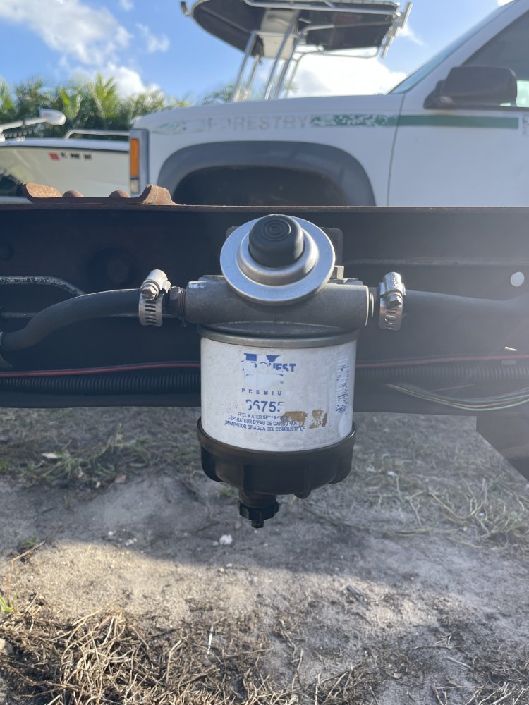

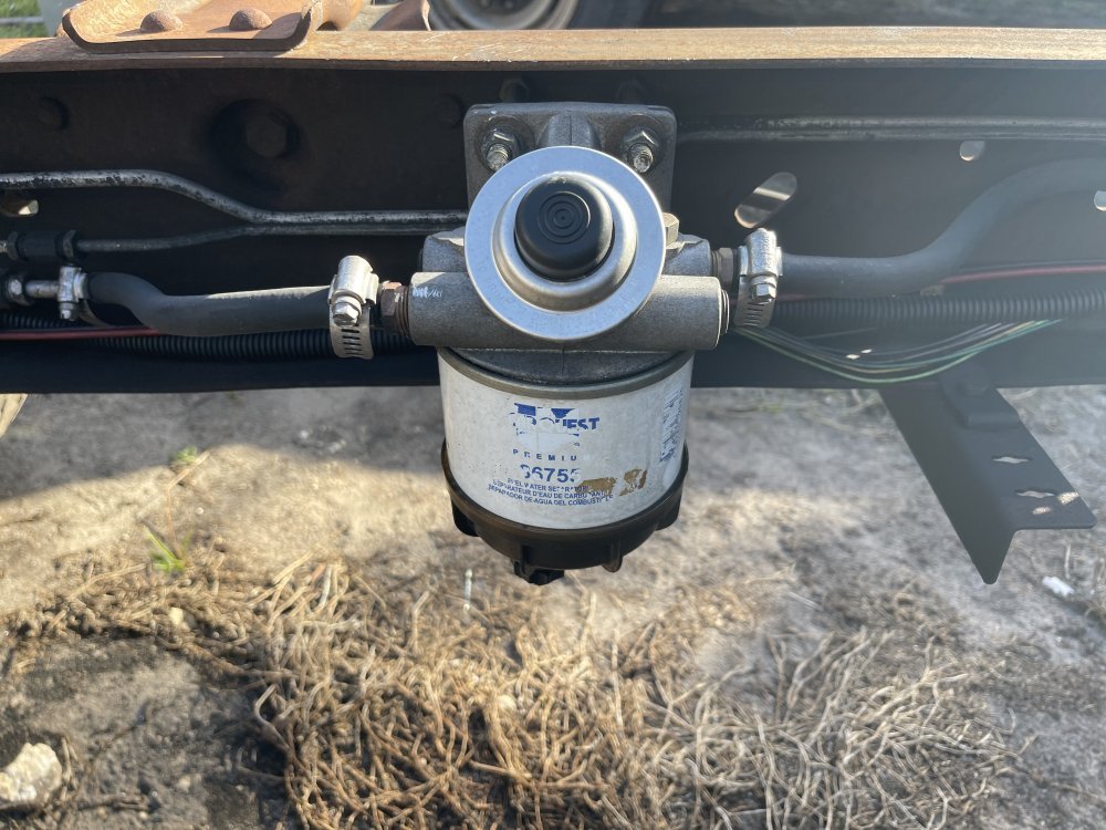

6.5L PRE FILTER WITH PRIMER PUMP

Interesting I looked up both the Baldwin BF825 and the Napa 3166, neither show online what the micron rating is. they both cross to each other, also crosses to a Fleetguard FF167 which again doesn't show the micron rating. I was able to cross them to a Donaldson P556245 which they show it to be a 14 micron at 95% efficiency.
there are several variations of this filter that will fit the housing, so you can get different micron rated filters. what's nice to have is the hand primer. that alone can help get someone off the side of the road when the lift pump fails to bleed the system!
I had in mind to remove the tank sock and to use this before my lift pump, but I think I'm going to tackle one project at a time and pass on this one, after thinking about it further. Thank you, though.
