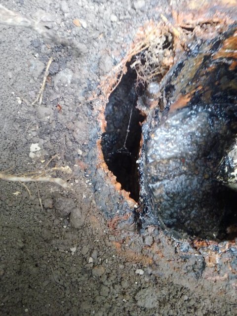

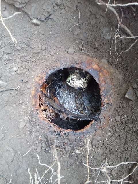

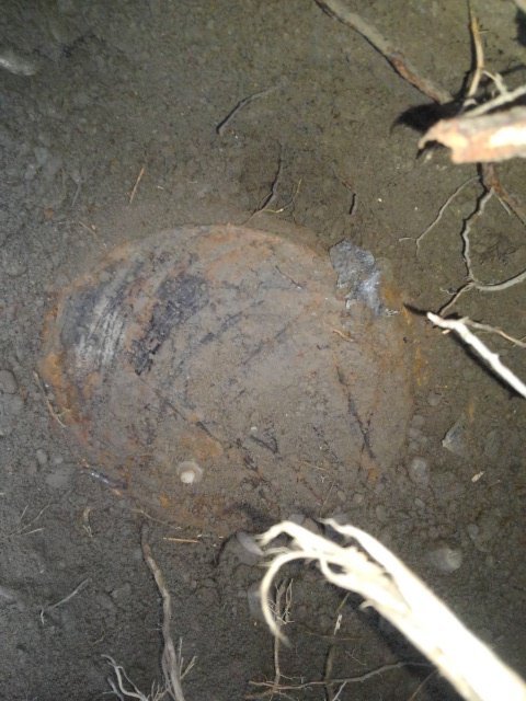

Ok so i got bored, and have been curious about the septic tank.... it's Not backing up or anything but wanted to figure out where it is and such because after tearing off the additions on the back of the house some of the pipe was above ground..also figured it would be better to find the hatch when the ground isn't frozen solid in case it needs to be pumped.... After deciding that a back hoe was in order my back, along with a shovel and hoe got to work.... After much digging I found the tank cover about 2 feet under ground.. the nut to the cover came of pretty easy with some pb blaster. .. come to find out it is a metal tank, the inlet baffel looks solid ld is solid etc. But not sure what I can tell about the actual tank condition with it full .... Code has no record of it being installed, but that's not a surprise cause codes only been in this town since the late 90s...

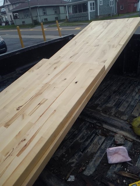

SCORE!!!! Wife was surfing craigslist and some people were giving these butch block countertops away for free!!! Brand new never installed...!!
Now I just gotta figure out how to cut a sink hole in one.. this stuff don't cut easy..lol
Figer out where You want the hole, mark it out exactly, then, take it to a cabinet shop and let them whack job it. Much smoother and they have all the nice stuff to accomplish the task. Probably take only a ten dollar bill too.
Build yourself an outside template for a router to follow. Then make each successive pass a little deeper. Use a straight cutting bit and then a round over bit to dress up the edges
if your handy with wood working, you can always build a section of the counter trying to match the butchers block that already has the opening for the sink or do a section for the sink covered in tile so that area doesn't get banged up by the pots n pans (not sure how hard the wood is). then seam the butchers block to it. just throwing ideas.

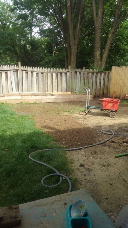

@prefixla welcome to TTS. And thank you. Yeah we got it for 9 grand, and we've done alot to it but much more to do. Today we're working on getting the second half of our lawn (where it's going ) dug up and seeded
That is valuable garden area Stoney! I see taters and corn in that area! Haha.
