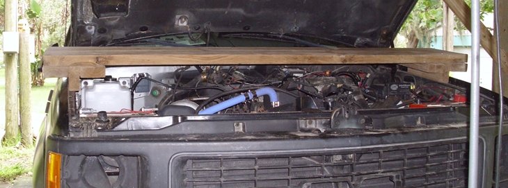

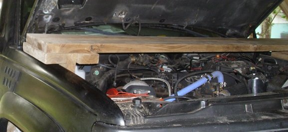

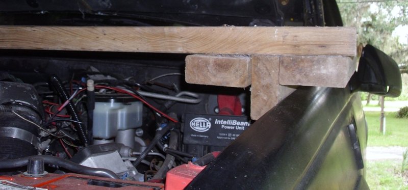

I built a platform w/12" wide plank & fastened two 16" 2x4's that rest on the fender (R&L) inner lip opening 'area that hood covers' omatching the hood opening angle wide in back & narrower towards the front, once in place the platform is solid and will not slip towards front of engine bay when in use.

Simple and secure- nice. What, maybe $4 worth of wood probably left over from a project. Can’t do that trick on my Hummer, since no front fenders, but I will be making something.

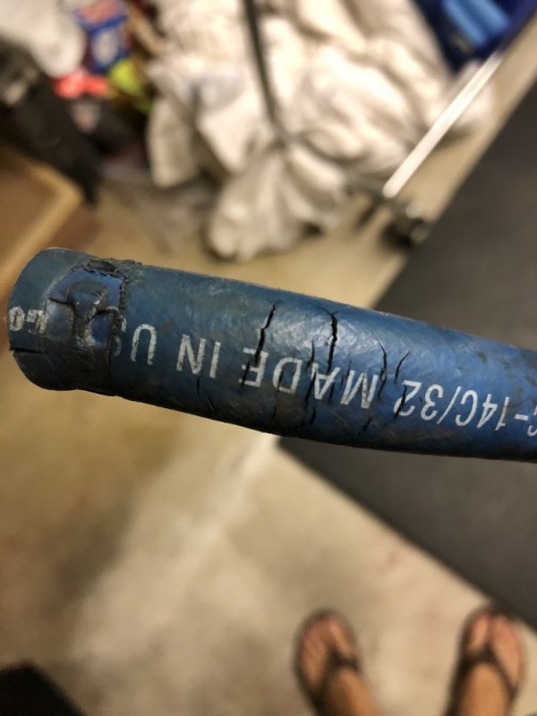

After dropping me off, he apparently went to work installing the OPS with the socket from Leroy. Got it done fairly easily and no need for the creeper board. He also found the FTB fuel hose from the FFM to the IP cracked and leaking so that got replaced and his new leak is now gone. He came over to show me the result and the Burb is back amongst the living. Hooray!
