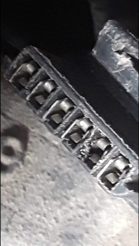

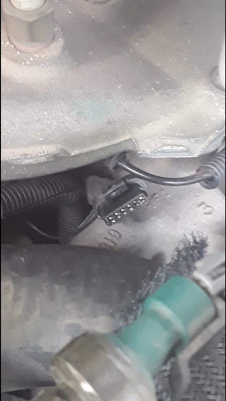

Where you plugged in the pmd, sometimes the pins get bent. Examine that closely.

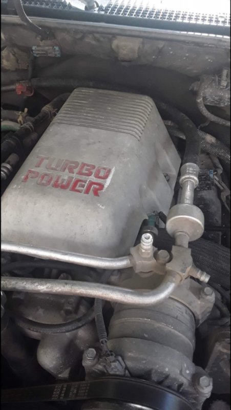

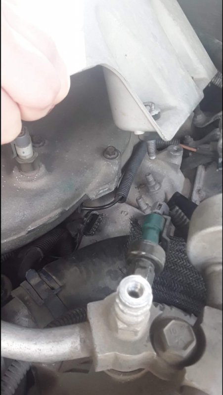

Thanks for your reply! Here is a link to a video I took this morning. The truck wouldnt start at all right before I changed the pmd. The pins all look fine and no codes.

I noticed 2 things. I can give book answers to why on anything- so if you want the info ask if in question otherwise I will type for hours and bore you.
1. The glows shouldnt go on and off like that so many times- they are not all heated up like they should be. It could be bad plugs(most common). ONLY use AC Delco 60 G!!
Could be controller issue but doesn’t sound like it to me. Could be the “wires” to the plugs- NOT Normal wires- it is special fuseable link wire used- do not try rigging test replacement wire- it will catch fire. Carefully examine wires for damage but easier is test for voltage at each plug connector, if all get 12v+ chances are they are ok.
2. You hear the lift pump run when key is on. It speeds up and slows down as plugcontroller sucks power. But it should go from loud to quiet and stay quieter if it were building pressure and maintaining it- yours is not. Your lift pump is toast is my bet.
I am a HUGE proponent of having a dash mounted fuel pressure gauge for these engines to see while driving. The LP (lift pump) fails and people dont know. Then the ip (injector pump) sucks fuel through it and it wears out the ip much faster. $100 pump vs $2000 pump- hmmm. Some 6.5s have a fuel pressure tap port to make it easier to test in shop, others don’t. I always say put a metal “T” at the ip inlet and read from there. Failed rubber hoses has cause many to replace good pumps if both types.
From any hardware store - get clear 1/4” line sold by the foot. You need a 5” long piece snd replace the ip return line with it. Also buy 2 new screw style hose clamps to fit the clear hose. This is to monitor for bubbles- air intrusion (also shows any contamination). About $5 and 5 minutes to do.
