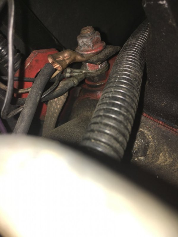

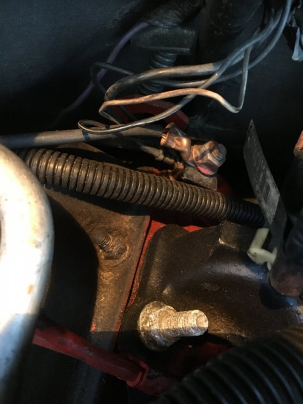

I dug up a picture that I took a while back. You can kinda see which wires need grounded at the back of the head. The big black solid stranded wire on top with crappy crimp was on there when I got the truck, I just haven’t fixed it yet.

Thank you,,I'll compare to what I have hooked up ,,looks like what I've got hooked,,,the 2 I haven't hooked yet that comes out the harness on the firewall,one has an eyelet on it that looks like it should be hooked with the others and it runs back to the computer harness that goes through the firewall passenger side and the other one has no end on it and is factory soldered to other ground wires in the harness,,,checking to see if it needs to go to ground or if it is broke off and I need to find the other end,,,,when I get back out there I'll take a picture of what I'm talking about,,,,thanks again for the pictures it will definitely help

If you have an automatic transmission it grounds there as well. IIRC if you have an auto it has 3 smaller ground wires. All of my trucks have used an intake bolt or front of the head for the passenger side battery ground
