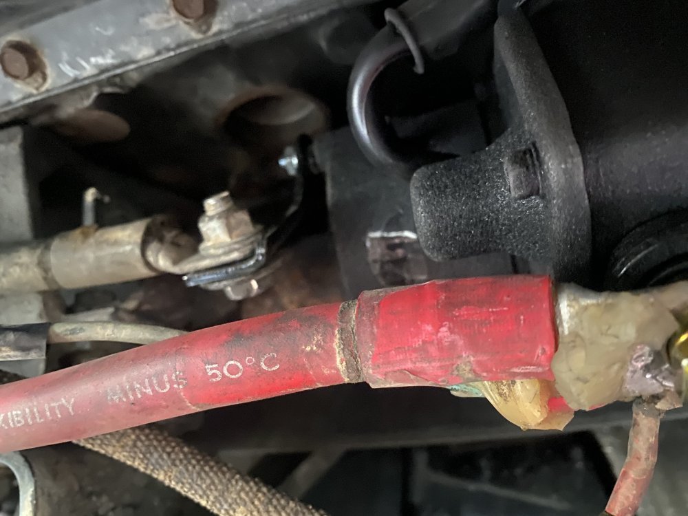

I just climbed under my truck to see the new starter that was installed and I am now unsure if the guy put the support bracket on the back (front of truck) starter. Would it be possible for me to run it over to you for a quick look and feedback? Plus it would be great to meet another Hummer owner here in town.

His mechanic installed the brace but not right. Hummer starters have the negative battery cable attached to its housing. He used the brace as an adapter to make the large battery cable connect to the starter housing. I can see how he thought that.
But He will take it to another mechanic and get it on there correctly now.
Then move the negative battery cable to the engine block. Most hummer owners mount it to the fuel pump block off plate, where pickups have the turbo drain.

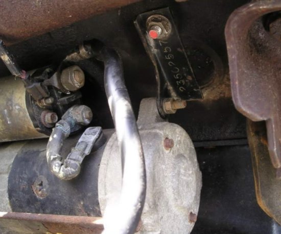

If anyone has a good pic of the front brace on a powermaster starter - can you please post it?
Here is how they are supposed to be with a gm starter.
Well the negative battery cable has a 3/8 eyelete where it normally goes on a stud.
The powermaster starter doesn’t have a huge stud. And fitting two 2/0 battery cables on the tiny powermaster starter doesn’t work well with the 10 gauge solenoid activation wire. So...he put the bracket on upside down and attached the negative battery cable to it.
If you have delt with the huge 100 lbs starter on hummers and hmmwvs- that is where the negative cable would go. So I don’t blame the mechanic who never worked on a 6.5 before. It looks like an adapter to get the cable to attach.
