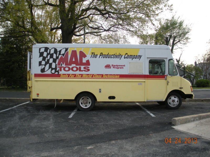

Hi! I have a 1998 Union Body 6.5 non turbo Mac Tool truck. Does anyone have a wiring schematic for this truck?

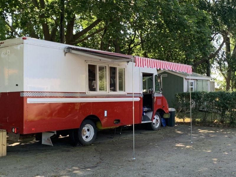

I don’t see any rv a/c-heater units on the roof. Is that yet to come on the build of not needed where you are?
Welcome. I don’t have schematics, but used to be a Mac Distributor some years back-.If I’d known then what I know now, the changes I would have made...
Hi Will L. Nice to meet you. I have a engine driven compressor and a roof vent (80's style ) I'm in New England and as my truck is "open" to the public ( order-serving windows) a rv type a/c would be useless. What changes would you make? I rewired the entire interior with 12-3 and 14-2 wire and 10 traditional plugs with a main 14 slot breaker panel. I also have a 7kw rv generator.

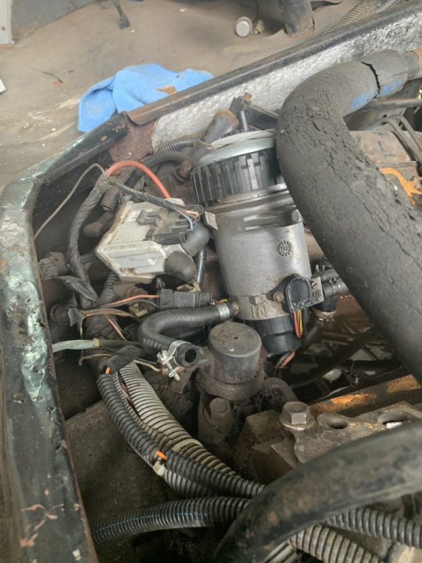

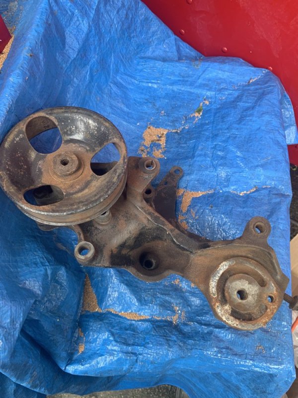

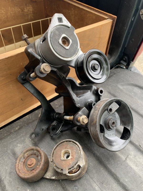

OK boys. Here's some pictures of my project.
Ist One - where the bracket for the alt was on the front of the block.
2nd one - the fuel filter- not installed - just cleaned

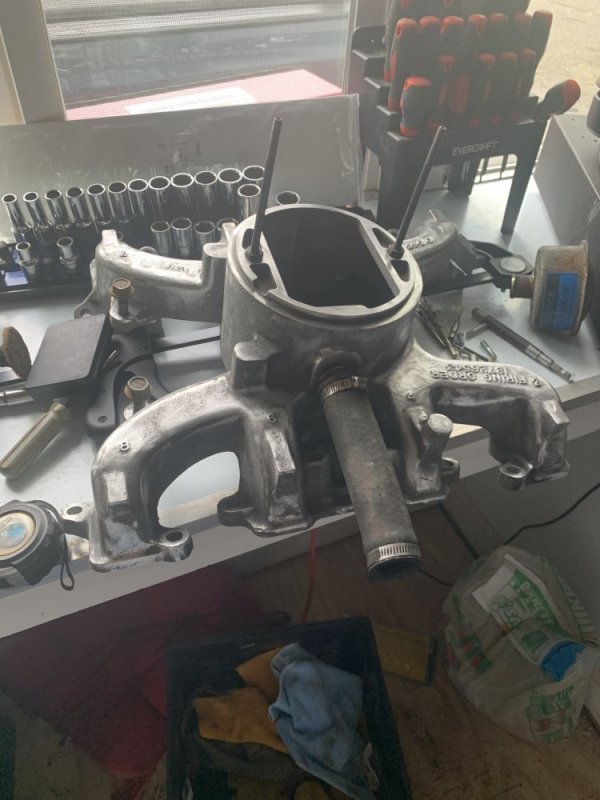

3rd one - My cleaned up intake manifold

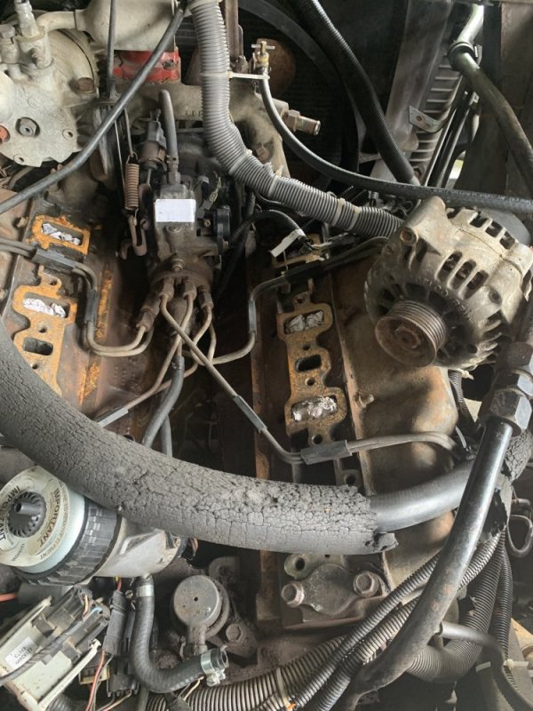

4th one my IP - notice the green wire clip on the top, just right of center, that was broken! could be one of my problems - it was like that I didn't do it. Green wire -ground?

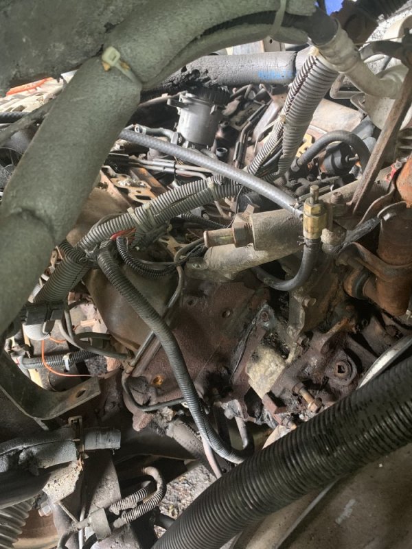

5th one - THE bracket _ the pain in the ass bolt is the center one in the deep indent -
6th one - the greatest easy out bolt or nut tool you'll ever buy. On Amazon. After hours of frustration this little gem backed the bolt out like it was nothing! I can not say enough about this tool!!!
7th one - The bracket - cleaned up - new tensioner, sandblasted and repainted.

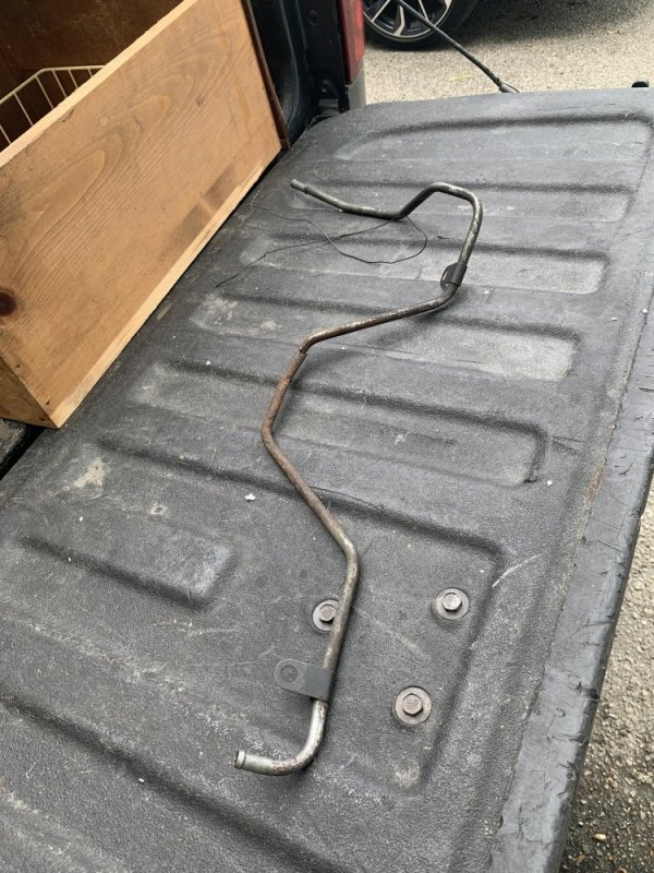

8th one - the reason for all this- notice the holes in the fuel line!

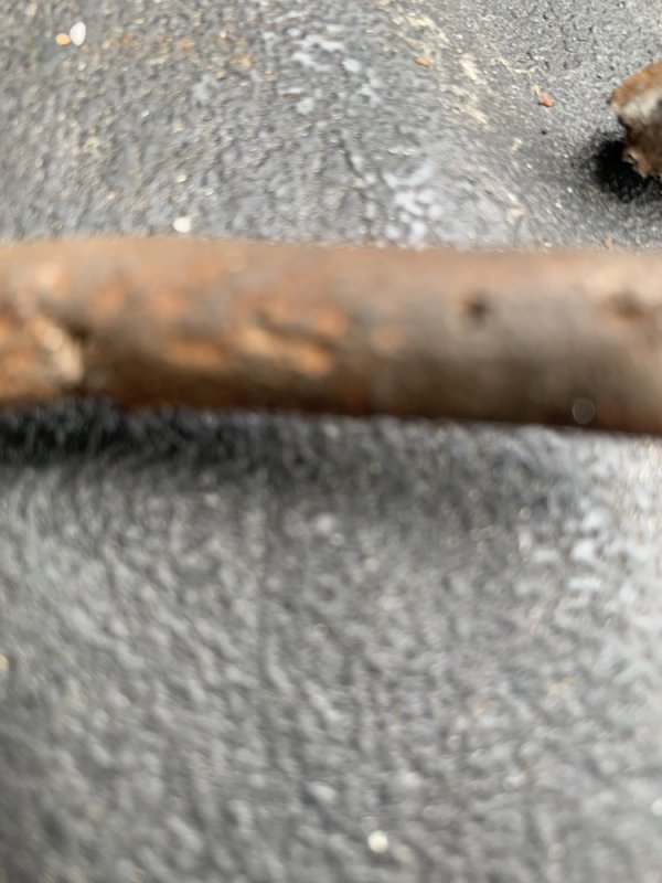

9th anmd last one - THE CULPRIT- the nasty old fuel line that got religion (holy) rotted out (broke in half as I removed it, and generally made my life miserable.
All this being said, I'm out of here, going to buy some new fuel line material and make up a new line. Enjoy the pics. Looking forward to your commets and ideas. Be well. Dan
