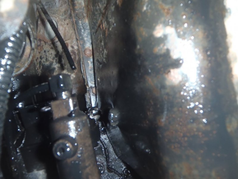

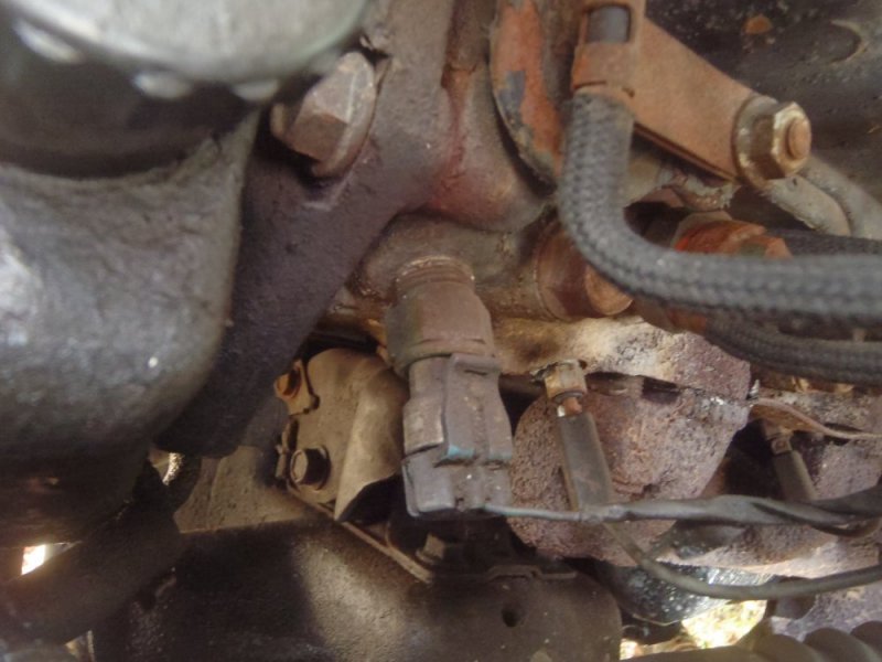

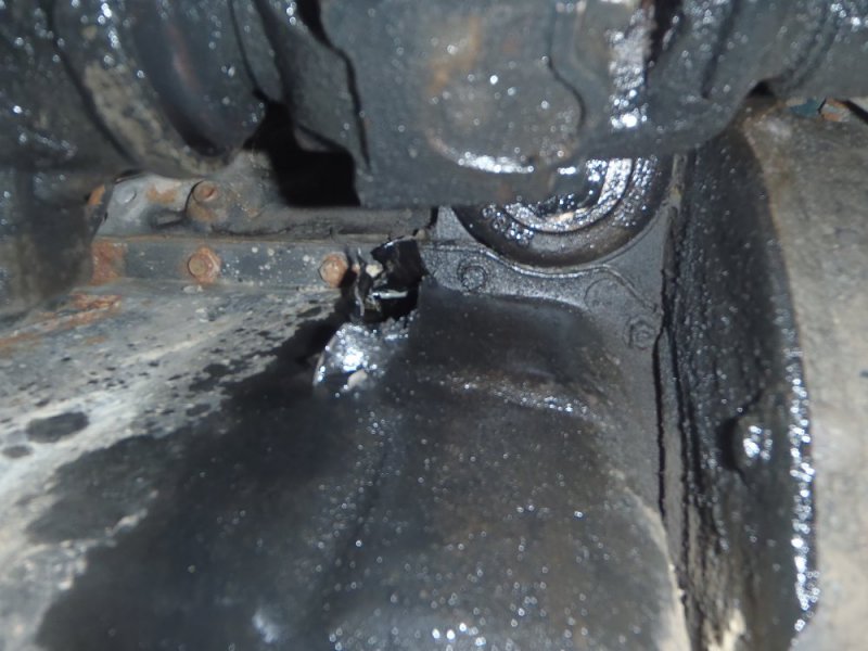

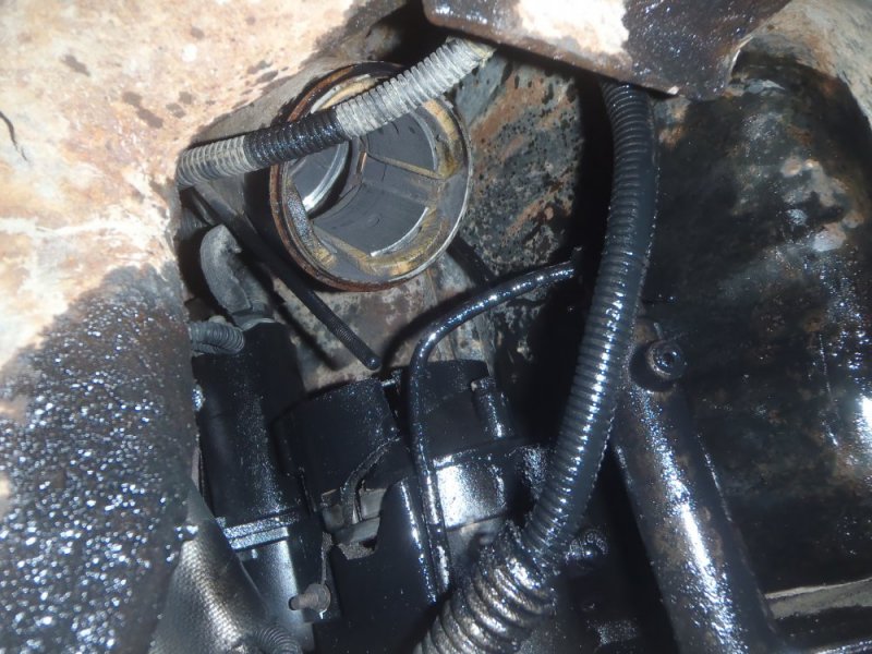

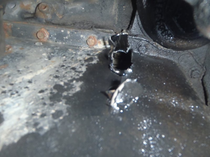

So I'm driving home from town, just crested the top of a hill and I hear a sound like something is dragging. I pull over, engine is still running, and turn it off. Look underneath and oil is leaking everywhere. I then see that the starter is completely blown to bits. This is what I heard rubbing/ dragging. After crawling under, I see that holes are blown in both sides of the oil pan. On the passenger side the blowout caused the starter to be completely blown off the block and into pieces, only held on by wires.
