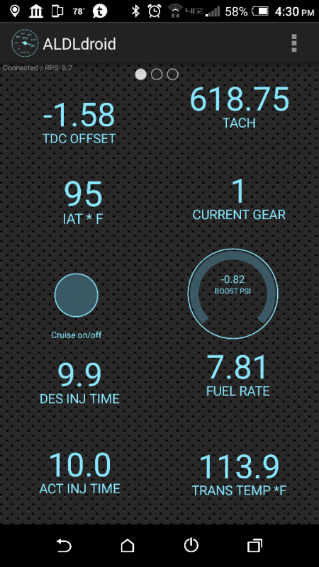

Stepper motor issues would cause both as well but should throw a code for a timing mismatch. Hard to tell without scan tool or data loggingScreenshot_20160925-163048.png

Looks like it might be time to try my hand at making a data logging cable, if the stock actuator doesn't work out. We'll see what happens with that. I'm not going to be driving it enough until this weekend to get any results anyways
