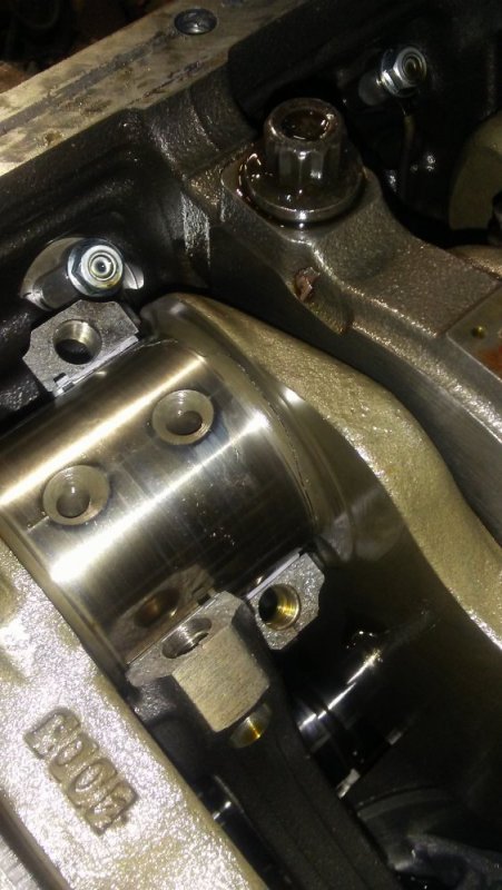

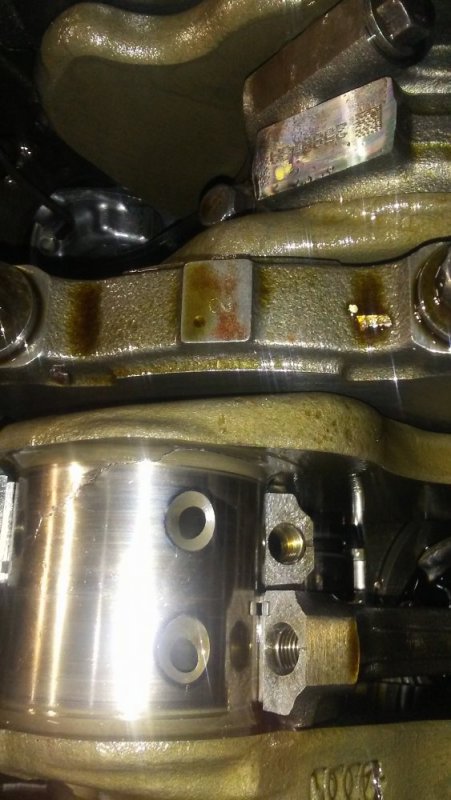

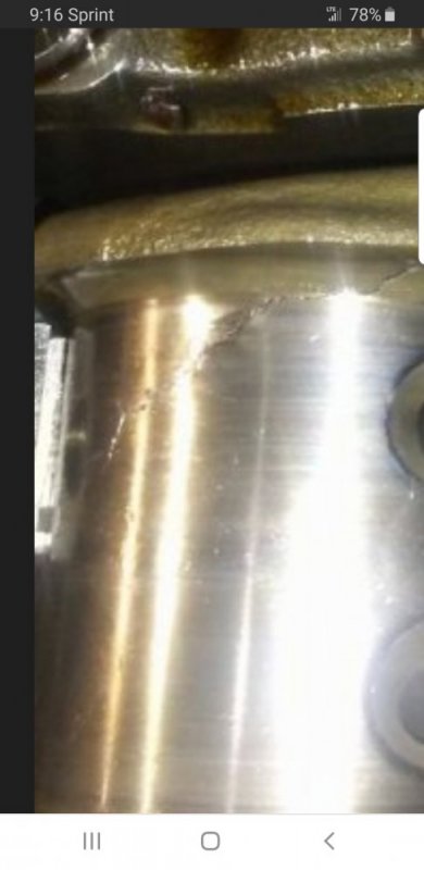

Broken on the first rod journal. It still ran ,but with a knock. Seems like they shouldn't have hollow rod journals,its not a racing gas motor.

That sucks. Maybe magnaflux would have shown an issue, maybe not. XRay is far better but more expensive.
Cracking often starts on the inside of the hollow section of the journal. You cant see in there when magna-fluxing because there isn’t a good place to set the magnet.
Any other angle pics of the crank? Trying to see a start point, Since it didn’t cross or start at the nicely done oiling supply that is sometimes a source.
