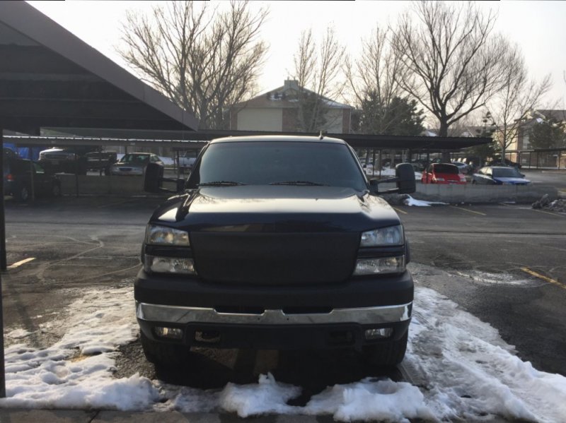

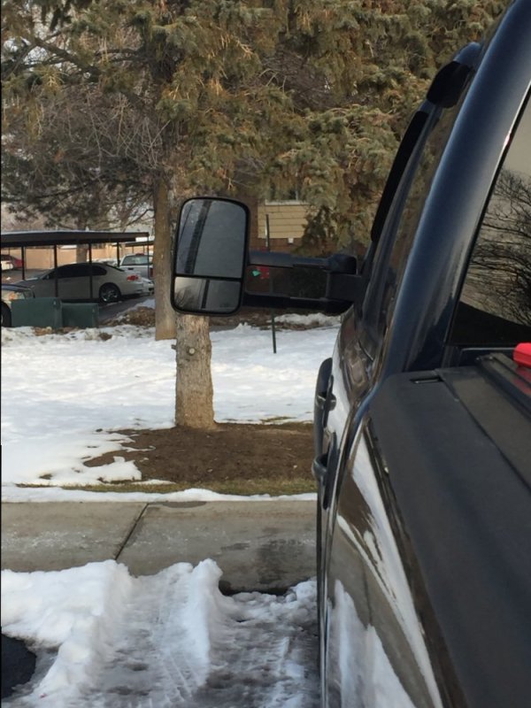

A picture before, not a fan of the tipped up mirror angle
Before picture with mirrors extended

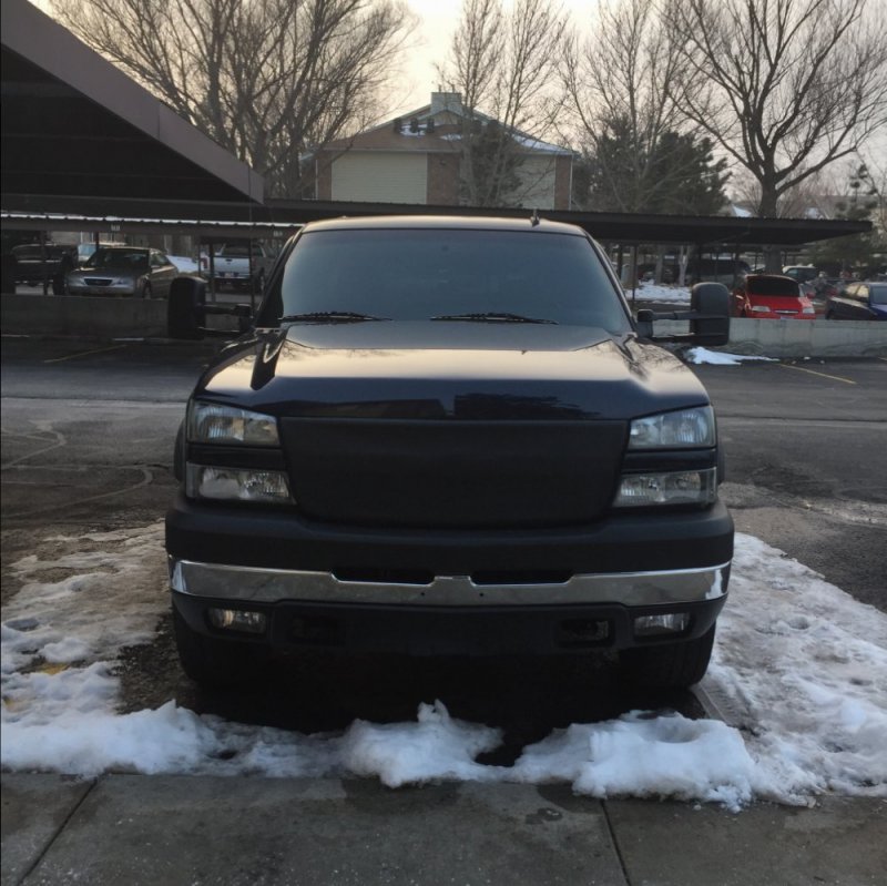

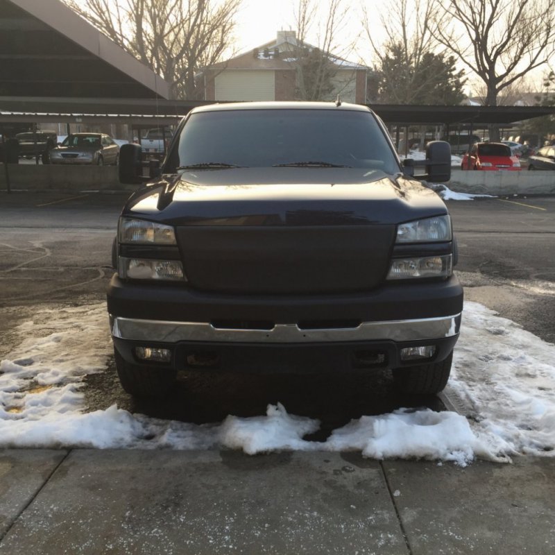

And one from behind just for fun.

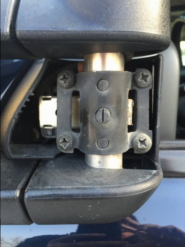

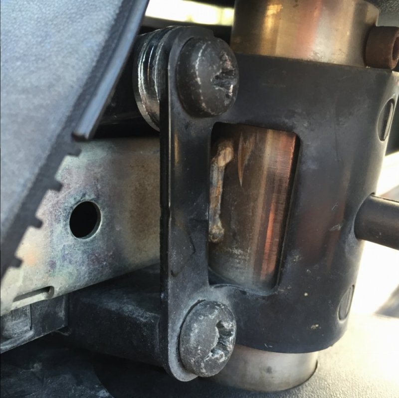

Its extremely simple to level your mirrors, job was done in about 30 minutes. To start you'll pop off the little plastic cover between the telescoping arms of the mirror. I just pinched the plastic together on both sides and it popped off. Some others mention using a flat blade screw driver and pry from the back(furthest away from the hood). Based on the year of truck you'll either find allen head screws or phillips. My 06 was phillips, shown below.
From here you will loosen the bottom two screws several turns, and completely remove the top two screws. Like most of us this mod will end up being free as we all have a couple washers lying around. I used 3 1/4'' washers per top screw (12 total for both sides).
Put the washers behind the upper bracket, tighten the screws down and you've leveled your mirrors.

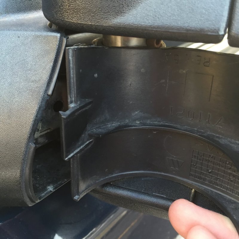

One more modification, now that your mirrors are leveled you will have to trim the top of the plastic cover piece you popped off in step one. There is a ridge on the back side of the plastic piece about 1/8'' to 3/16'' from the top, if you trim to this line it will allow enough room to let the mirror swivel yet not show too much gap. I ended up doing this with a razor knife, and yes I cleaned up the top so its not choppy and uneven looking like in the picture below.

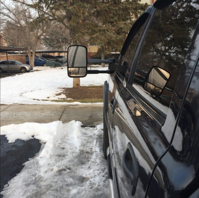

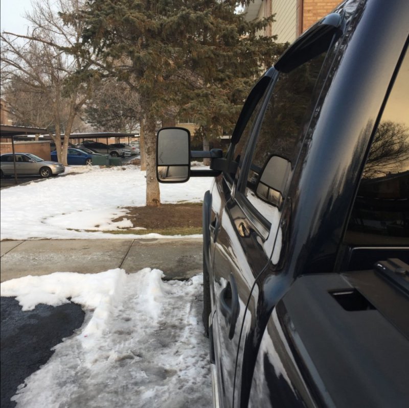

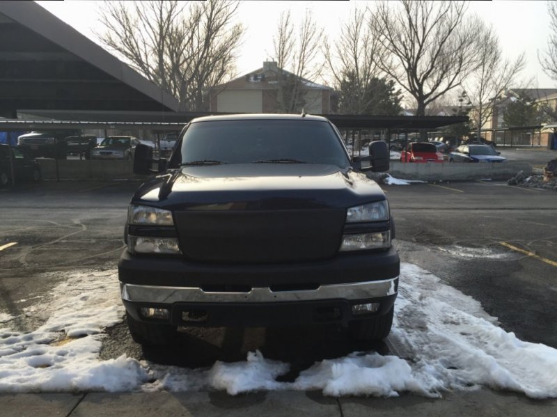

Now the finished product. Enjoy
extended
extended from the back
normal from the back
