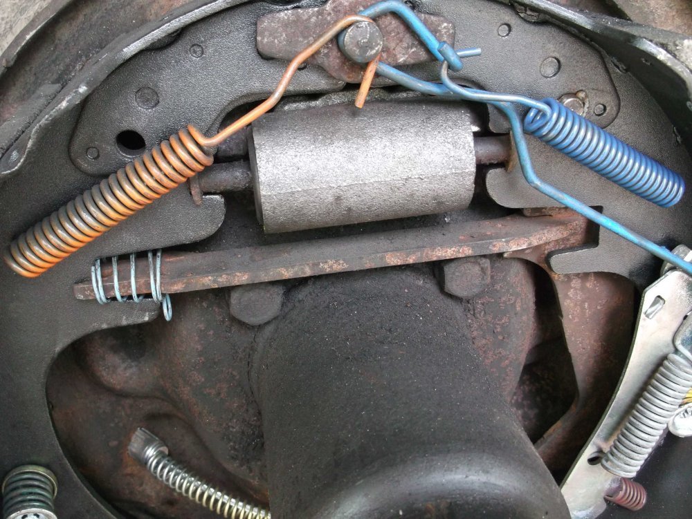

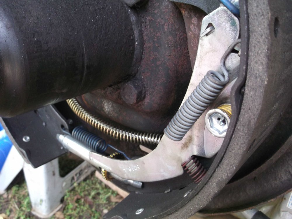

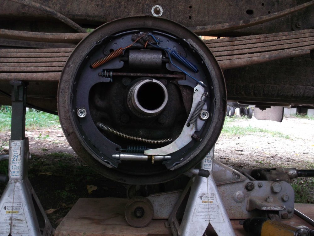

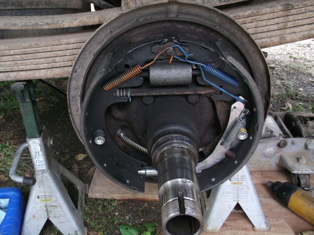

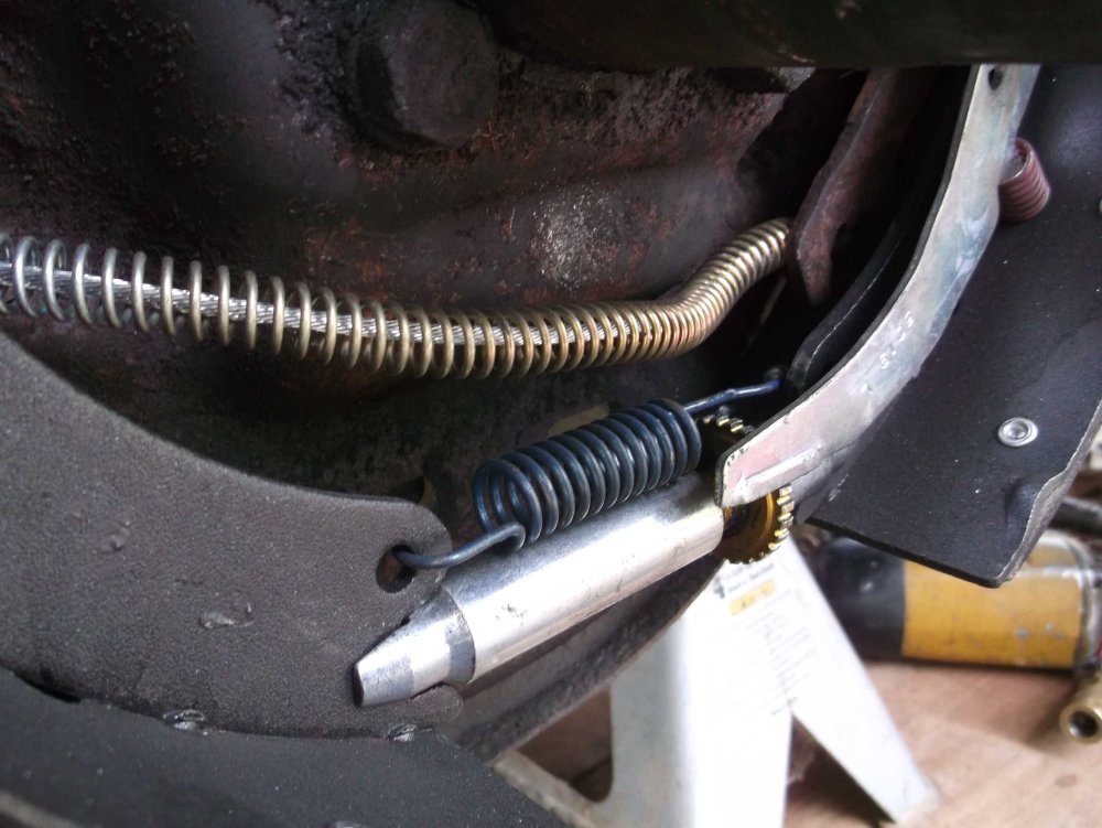

OK, the short shoe appears to be toward the front of the truck. When the parking brake is applied it just takes up the slack in the linkage to the primary shoe. There is about 1/4 inch gap before the slack is taken up in the linkage and pressure started to apply to the shoe. That is with the adjustment all the way toward tighter on the parking cable. I would guess they put a cable back on that is too long? Pix attached....BrakeAdjustArm.JPGAllOfItCentered.JPGBrakeCableAttach.JPGTopCloseUp.JPGTopView.JPG

The cable length shouldn't be a factor here so long as the ends are attached in the same place as the origional. there is another adjustment up under the truck where the two cables come together into a bracket. there the cable from the pedal comes back to this same bracket and there should be a threaded rod with some adjusting nuts. make sure all that is adjusted properly. the cable from the wheel to this bracket might be longer than the origional but can be routed is a mannor so that the extra length is up out of the way. what matters is the length of the inner cable to the outer sleeve or to better explain it. the distance from the end of the sleeve to the end of the inner cable on both ends. if that is too long, it will cause issues.
