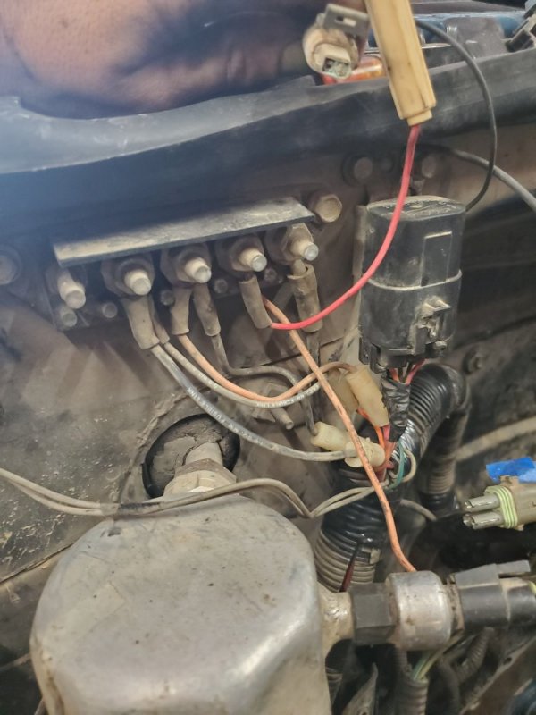

I have a 1994 gmc siera sle k1500 with the 5.7l 350 tbi my question is after hours of searching I am still unsure about a junction block on the passenger side firewall behind the coolant tank there are 5 nodes with a jumble of cut wires and I would like to get everything rewired correctly if anyone could tell me what this component feeds its just between my fuel pump fuse and the relay

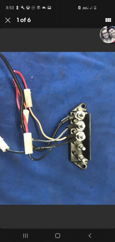

This is not my unit just a picture of the part I'm trying to figure out i will post a picture of what is in the truck tomorrow I know 1 node has a wire directly off the positive post from the battery but I have about 4 wires that have been cut and the far most left node has nothing attached at all

So that is the power junction block. It is supplied power normally from the starter although I think it is sometimes a one piece wire. Those individual nodes as you call them all should be hot and supply power to the rest of the truck

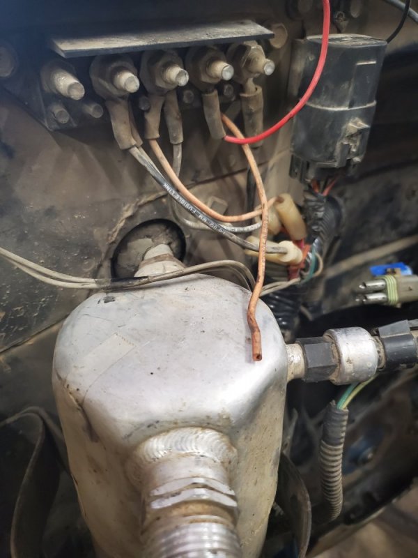

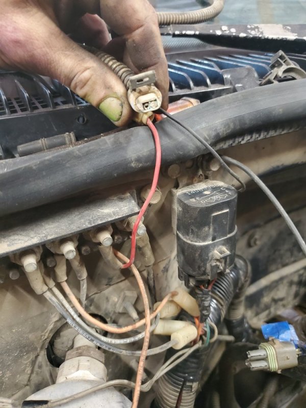

This is my setup trying to figure out what the plug im holding is for and what the orange wire is supposed to feed

Thats what I initially thought however the light has no plug and the 4 foot worth of wire made me think otherwise found it tucked into the frame under the door
