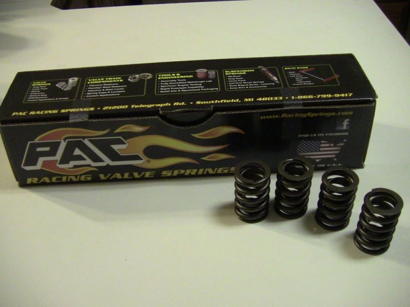

Specifications
  • Outside Diameter 1.355
  • Outer Spring ID 0.940 in.
  • Middle Spring ID Damper
  • Damper Yes
  • Inner Spring ID 0.851 in.
  • Install Height 1.85
  • Load at Installed Height 90
  • Spring Open Height 1.35
  • Spring Open Load 300
  • Recommended Valve Lift 0.55
  • Spring Rate (lbs/in) 418
  • Coil Bind (max) 1.2

Some will ask why so I will answer that now..
How many have checked new stock springs? Well I have, they are border line wrong for a stock motor much less more fuel and more boost..
Some of the valve prints on pistons are strike's during valve float. With a low pressure spring and added boost psi, miles & years of heat cycles the weak stock springs just don't cut it.
So for under 100$ new custom specific springs is always a good bang for the buck.. Everything in the valve train is weighed, cam specs, boost & back pressure, rpm, etc are taken into account and out comes a spring that will best suit a build.
After all we know GM didn't spare anything during production on these motors don't we...

I'm working to be a reseller for them now. I could get them if someone wants a set...
This is not my first set from them but is the first specked for these motors...
These were specked for my build but would work great for a motor with less mods also...
