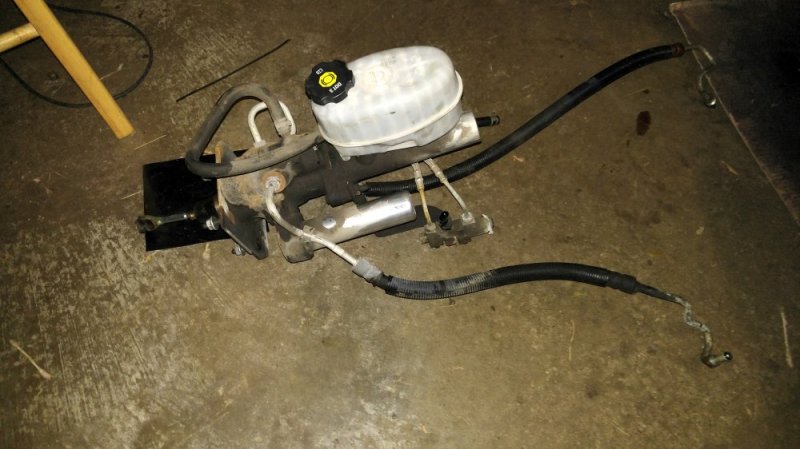

Hello all, longtime lurker making first post. Seems there is allot of wisdom here and I would like your opinion on something.
I have an 1997 K1500 Suburban, it has a Superlift K270b 4"-6" lift, BFG 35" Tires. I just completed swapping in a 9.5" 14bolt SF rear with Dual Piston Disc Brakes from a 2002 K1500 Suburban.
The brakes on this truck have never been stellar as you know and I have been reading about swapping in a hydroboost system from a NBS truck. This past weekend I got a Hydroboost system complete from a very clean 2005 Z71 Suburban at the wrecking yard.0616182212.jpg
After reading through this thread: http://www.thetruckstop.us/forum/th...ng-or-brakes-ps-tank-overflowing.43943/page-3,
I'm wondering if this is a good idea.
While the brakes are not stellar on the suburban, they have always worked and the power steering has been flawless.
By installing the Hydroboost it sounds like I could introduce both steering and braking issues to my truck. I know I need to do something to adjust for the braking bias now that I've added rear disc and I is possible to user the master cylinder from the the 2005 setup alone and get slightly better brakes.
I guess my ultimate question is the hydroboost braking worth the added complexity and addition points of system failure?
I'm a fairly handy with tools and I have know doubt I could install the system properply but sounds like even if I do that, there could be problems.
I'd like to hear from you all what you think and would you do the swap.
Thanks in advance.

Most simply swap in the nbs master cylinder with the existing vacuum booster, and say they get a nice braking improvement. And if you can find one, GM used 4 wheel disc brakes on the 3500HD trucks from 95-02 with the same abs system. If you can find one, you can get the proportioning valve out of one to increase your rear brake bias. I've read(not verified) that the 97-99 tahoe's sold for police use with the 130mph speedo also got the same proportioning valve.
I got the 4wheel disc brake proportioning valve from the 2005 Hydroboost Suburban, already plumbed to the master cylinder. I would think that it should work.

That's a huge mistake unless you've done away with your stock abs(that is where your current proportioning valve is), and swapped over to the new style abs system as they have brake bias function built into the hcu of them that works with the external proportioning valve. Adding another valve without the proper changed would kill your rear brake bias.
So using the master cylinder alone w/o the proportioning valve or the Hydroboost Booster with the factory ABS is the best option?

I don't think the rear disc brakes will cause a braking imbalance, but I would have first converted to the GMT 800 front disc brakes with dual piston calipers. Those alone make a huge difference in stopping power and brake pad wear.
Your mixxing and matching parts in a fashion that is quite honestly dangerous. In order to run the new style proportioning valve, you MUST remove your factory abs unit as it has a proportioning valve in it already. You should never run 2 valves as it will greatly cut your brake pressure down. I would have done just the master cylinder swap, and then found the CORRECT proportioning valve for your abs unit. Otherwise swap to the new style master, do away with your stock abs, and add in the new style proportioning valve.
