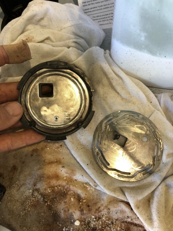

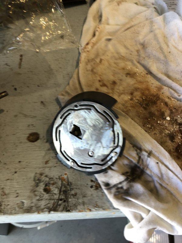

Found out the horn switch was rusted and not allowing contact. I was able to cut the plastic rivets and separate the metal plates. After that, using my Dremal I cleaned up the plates. I could only put back 2 rivets to keep the circuit open. Horn works great now.
