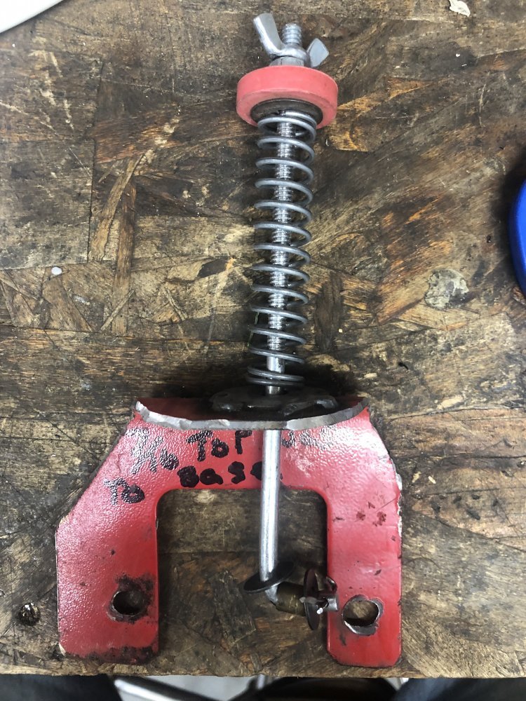

I had this TM on the truck several times and so I wrote with a magic marker how far to adjust the spring tension from the top of the shaft to the top of the washer atop of the spring.
Even with that measurement the spring tension would have to be readjusted according to the boost gauge.

Heath's told you measure the compressed spring length to get X amount of boost.
Because he didn’t drive an empty truck, read boost gauge, then load the truck and tow up hills. He didn’t try it out in horrible aerodynamic vehicles like bread trucks or hummers before using that method.
It’s a ball park method he came up with- but doing it isn’t exact. It required him building the units all using identical tension springs on engines using the same turbo at one altitude.
