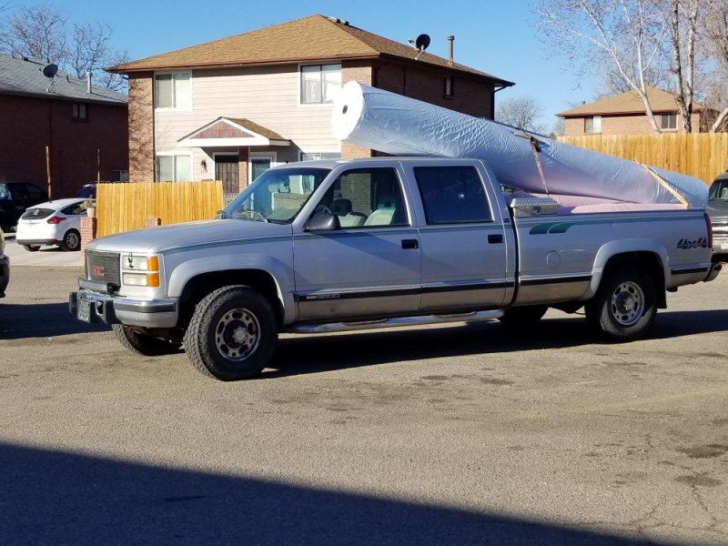

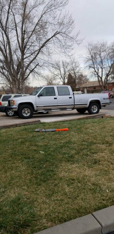

I got this 1994 sierra diesel and the engine blew out few months ago so now it's in the shop, they are rebuilding the engine, my questionis if you guys have any recommendations ??20180303_082609.jpgreceived_994167067408945.jpeg

Welcome To the Truck Stop. Truck is pretty clean. The guys here will be able to give you plenty of good tips and advice. I made your pictures full size for you.
