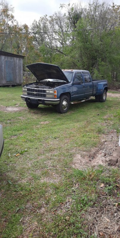

Ok so this is going to be kind of a long post so PLEASE stay with me. lol. We bought a 1993 C3500 6.5 turbo diesel knowing it doesnt run. The kid we bought it from had no idea what was wrong with it he just jumped into it blind. So did we.. BBUUTTT for $1400 we could not pass it up. I have talk to the owner the kid bought it from and he said he wasnt sure what was wrong with it but he thought the injection pump was out or going out so he replaced the lift pump in hopes it was that but he "is to old the keep messing with it". The kid had put new batteries thinking a quick battery swap would magically solve all problems and the truck would run. He was wrong got frustrated and sold it to us. We were thinking okay great. Lines need to be bled because well the lift pump was changed and it stopped running. Driverside lines bled, front passenger side line bled... Heres where my questions come in....
