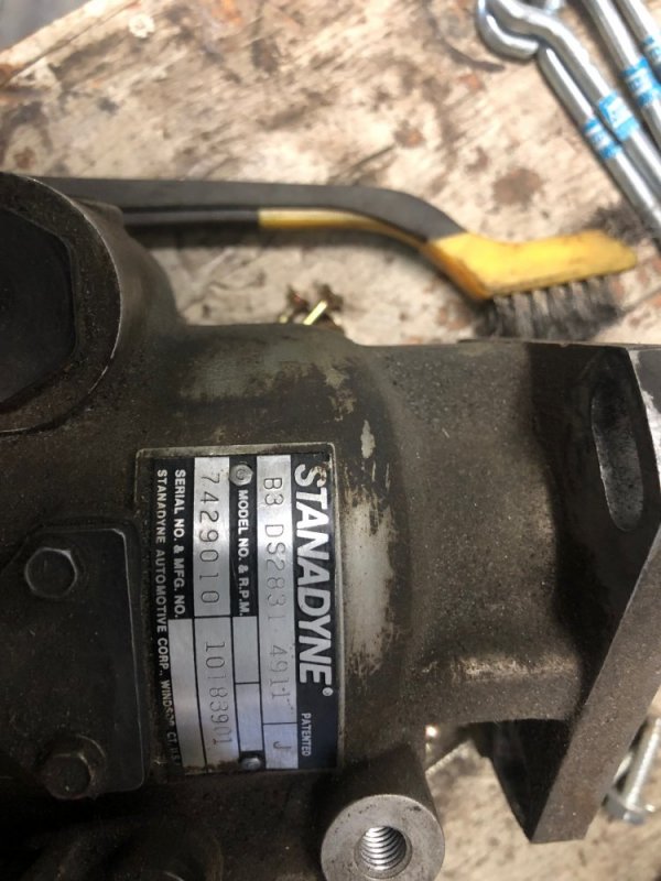

Its been a while. I'm trying to determine when and what vehicle the DS2831-4911 injection pump was used. I could not find anything on the sticky or on a search thru the threads. Any help would be appreciated.

The labels are removed, and blank labels are bought by pump rebuilders who are responsible to stamp the correct numbers onto the new blank plate.
That pump was rebuilt (hopefully) and the guy messed up and did “DS” by mistake. That is a DB pump.
The DB2831-4911 is the most sought after pump because it was the one that can be a good daily driver or hopped up power one. (There are others that do the same thing- but that number got popular online for some reason.)
It is possible just the numbers are stamped and plate installed and it has nothing to do with what the pump really is. I have seen several ebay pumps this happened to. Basically bait and switch- Hopefully not yours.
What is the deal- was that on your truck and now you need a new pump? Thinking about buying it? Or what...
Try your search with “dB” instead of “dS”.
Will, your explanation sounds reasonableIt came off of a donor engine. This is a for a truck project I am working on. At the time I got the motor, I was still recovering from a pretty bad car accident (head-on with a semi) so I did not go over the engine with a fine toothed comb. I wanted it mostly for brackets, manifolds, etc and the IP

The mistake of DS instead of DB is an easy one. These guys in the pump shops have to rebuild them both, and plenty of others. So a goof up isn’t unheard of. Coming off a runner, this is more likely.
Clean it up and try it is what I would do. You don’t know till ya know- ya know? Then if it has issues you can send it in to have checked out.
