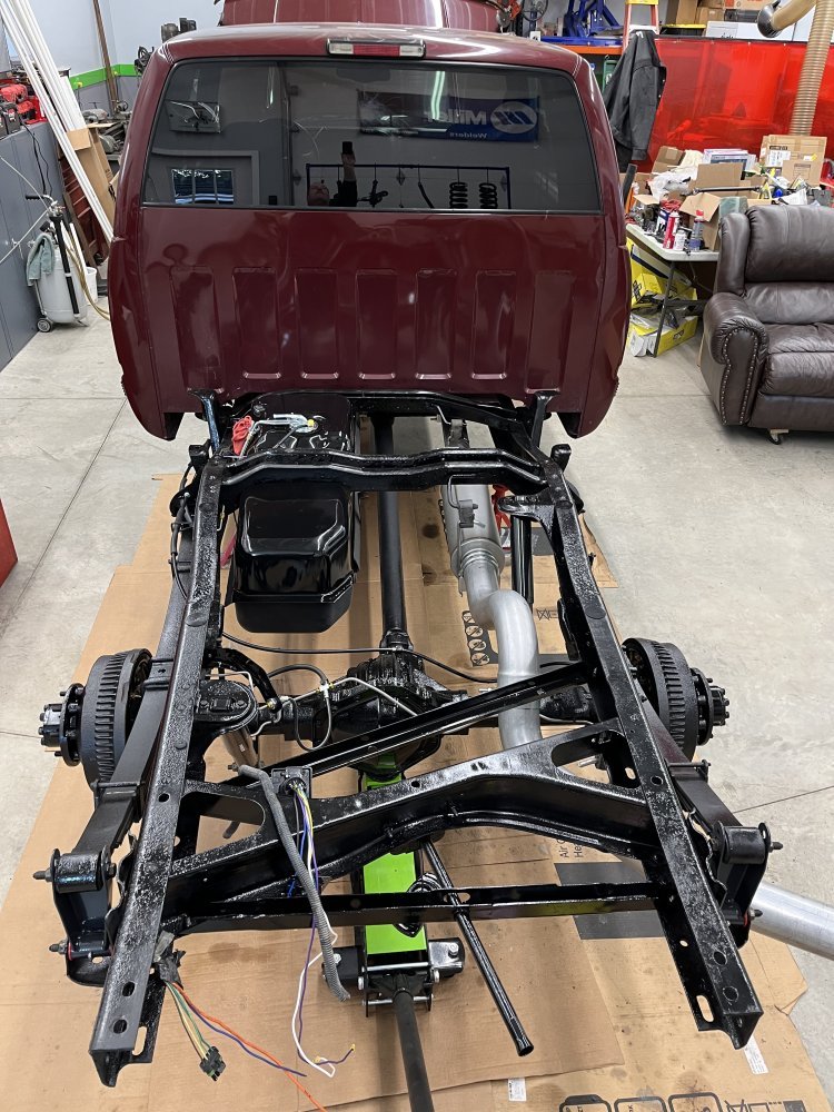

It also isn’t my first choice on a fresh repaint of the chassis and bottom of the truck… or when you don’t have a place to do that… if this was just a dirty old everyday truck I’d be all for the back field but it’s not an option on this one.

Nice looking rig btw- I get why you aren’t fond of the gravel method.
