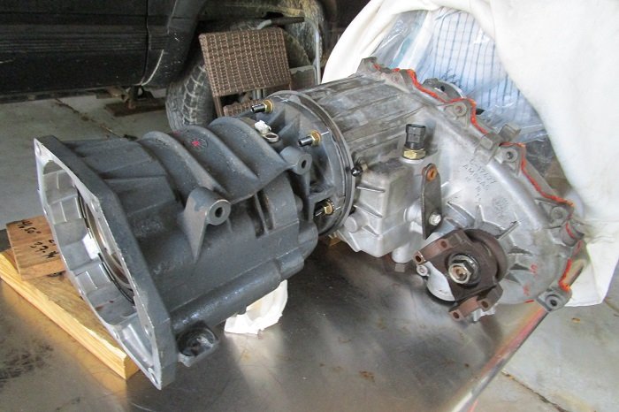

It is the input shaft on the NP241c from the output of the 47/48re Hybrid 4x4 O/D unit which is shorter than the 47rh 4x4 O/D unit plus a 3/8" clocking ring because there in not enough area for me to slot the 47/48 re 4x4 O/D unit 5th bolt too match and bolt the NP241c to it. Ideally a Dodge NP241 DLD front case half would be great because I could use an off the shelf 4 5/16" shaft but I've had trouble finding one...
I am also running two (2) VSS sensors the Dodge 4x4 O/D unit for the trans controller and the GM unit in t-case for speedo and ABS...

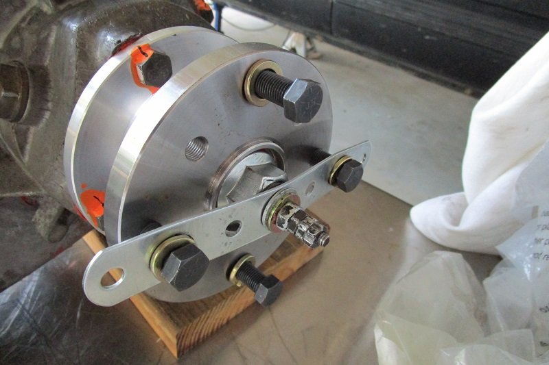

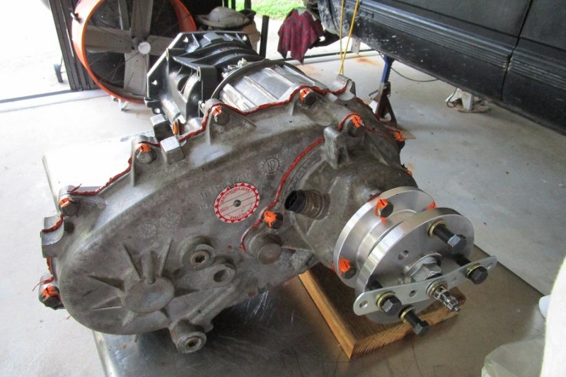

Well, I decided to re-assemble the t-case then cut down the input shaft by spinning it with a 1/2" big torque drill after seeing a utoobe video on how too do it... I need to make an adapter to fit the rear output flange for the drill chuck to attach as the shaft is spun on one end I can use a cutoff wheel on the input shaft for a short spell then let it cool then another short spell of cutting then cooling until I cut through the shaft...I was amazed how easy and square cut the process is.
