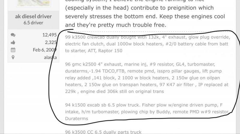

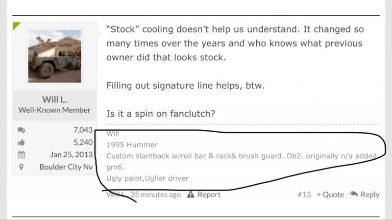

See where AK diesel driver can just say “my 99 has this issue” and we can see truck details with mods to respond or me is the 95 hummer?
I don’t remember how to alter signature line, but that is that area. Fill out truck details there and we can see what you have. Reading threads we cant tell what you have on profile page so we donit in signature.
Take pics of your waterpump, clutch and fan and post them here. If fan is metal Look on blades for stamped number. Getting the complete system makes it work well, having 90% of the right parts doesn’t mean it is getting rid of 90% heat. Infact if people they add parts one at a time, then finally add last part and it works good all the sudden and think- oh it was that one thing. Then tell others- get this one part and it doesn’t help them. It is a collective approach that works.
